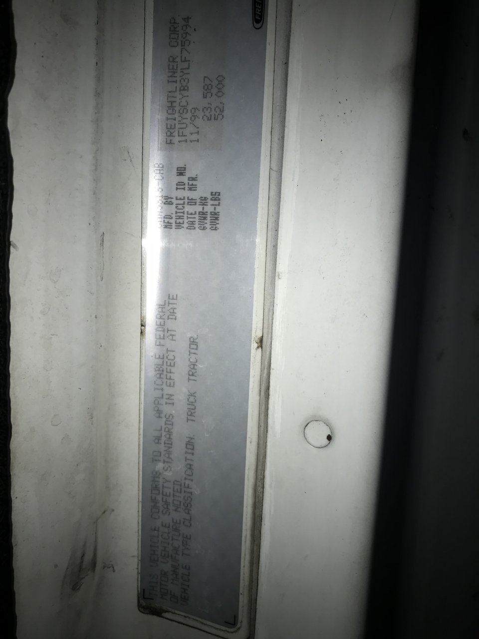

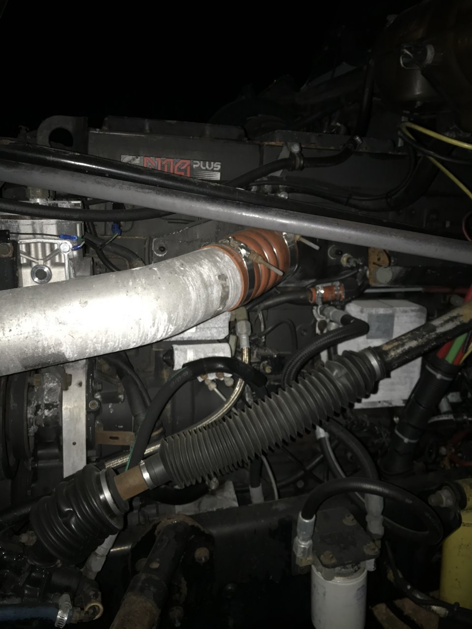

    Can’t see plate because of how cummins puts tag but this is motor and vehicle tag.

    It is not the date the engine was manufactured. It is the "model year EPA regulations" it is built for. The decal on the engine, which may be unreadable now, but can be replaced by Cummins was designed to tell mechanics what parts and procedures to use repairing the engine to keep it legal for emissions.
    The truck you see on the left is a 2000 Freightliner Argosy by the vin, but was assembled on Oct 23, 1999 in Cleveland NC with a Detroit Diesel series 60 engine built to EPA 1999 specifications.
    It is exempt.
