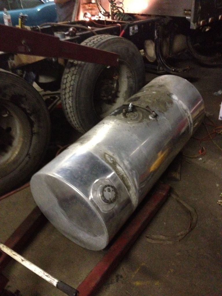

    My dad found someone who would sandblast and paint the frame so we spent last night dropping the fuel tanks off which was a pain in the rear!!! We had planned on just using a transmission jack and sliding it out. Those fuel tanks are skinned up anyway and we're looking for new ones so we thought a transmission jack would be a good option. Wrong. If you jack the tanks up high enough to get over the bottom of the saddles, the top was going to catch on the light bar below the cab. I think I also forgot to mention that these tanks were half full of fuel. This made the task all that much more difficult. What we did was used that jack to slide the tanks towards the rear of the cab and then once we got them out so far, we used an engine hoist to hook a strap around the tank and dad pulled backwards on the tank while I balanced it so it didn't lean one way or the other. It took us around 5 hours with all the problems we ran into. Not to mention on the driver side, we had to remove the step and the box that the battery terminal deals are in just incase you have to jump it.
