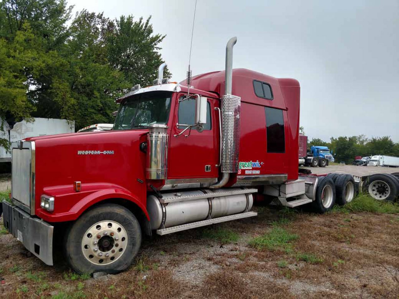

    I'm coming up on the one year anniversary of purchasing my first truck, a 2006 KW T2000 that was already leased on with my company. The company allows the truck to continue under lease with the seller, with all revenue assigned to me. While I was able to seamlessly get into an owner operator revenue stream, the truck has been nothing but problems.
    For one thing, it's plastic. I run oil field roads. Both doors can't shut properly (I posted a thread earlier showing the notorious problems with cracking T2000 doors). I did replace the bumper with a stainless steel bumper, but that just got mangled by the mother of all potholes hidden under a muddy pond on a dirt county road.
    The biggest money sink is the god-###### Cummins ISX with EGR. I would be money ahead to have simply dropped a remanned Detroit in it.
    I will have this truck paid off before the end of the month. Now I have a choice. I need a truck that can withstand lease road abuse. When I picked up my truck from my mechanic last week I talked to him about what I am looking for. He walked with me to the back lot and showed me a 2000 Western Star he has that has been sitting for two years without running the engine.
    He would sell the truck to me for $25K and take my truck in trade (no price established on the KW). For $25K he would drop in an 18 speed and put full separate locking differentials on each axle, and give me a six month power train warranty. I told him I want both tanks drained, cleaned, and filled with new diesel before cranking up the engine. I checked pricing on that year Western Star and it $25K seems fair.
    It will take a couple of months for him to get the WS ready, working it into a side schedule in his shop, once I decide to pull the trigger. I would like feedback and comments from folks that run off road.
    One specific question I have is whether the engine qualifies for running paper logs. A fleet owning friend of mine said the "E" model CAT of that year has an ECM and will require e-logs.
    Here's the specs:
    VIN 2WKPDDCJ3YK960956
    ENGINE CAT 3406E
    TRANS RTLO 18913A
    FT AXLE E1200I
    RR AXLE DS404
    MODEL 4964FX (2000)
    MFR DATE 3/1999

  9. G13Tomcat
    G13Tomcat Road Train Member
    11,872
    42,143
    Jun 7, 2011
    Man, she's a beast!! How's that condo?? Wow. Inside pix next time. Looks like he did some customization, himself (<<that's usually a good sign she's been taken care of properly...)
    Smut and Lepton1 Thank this.
