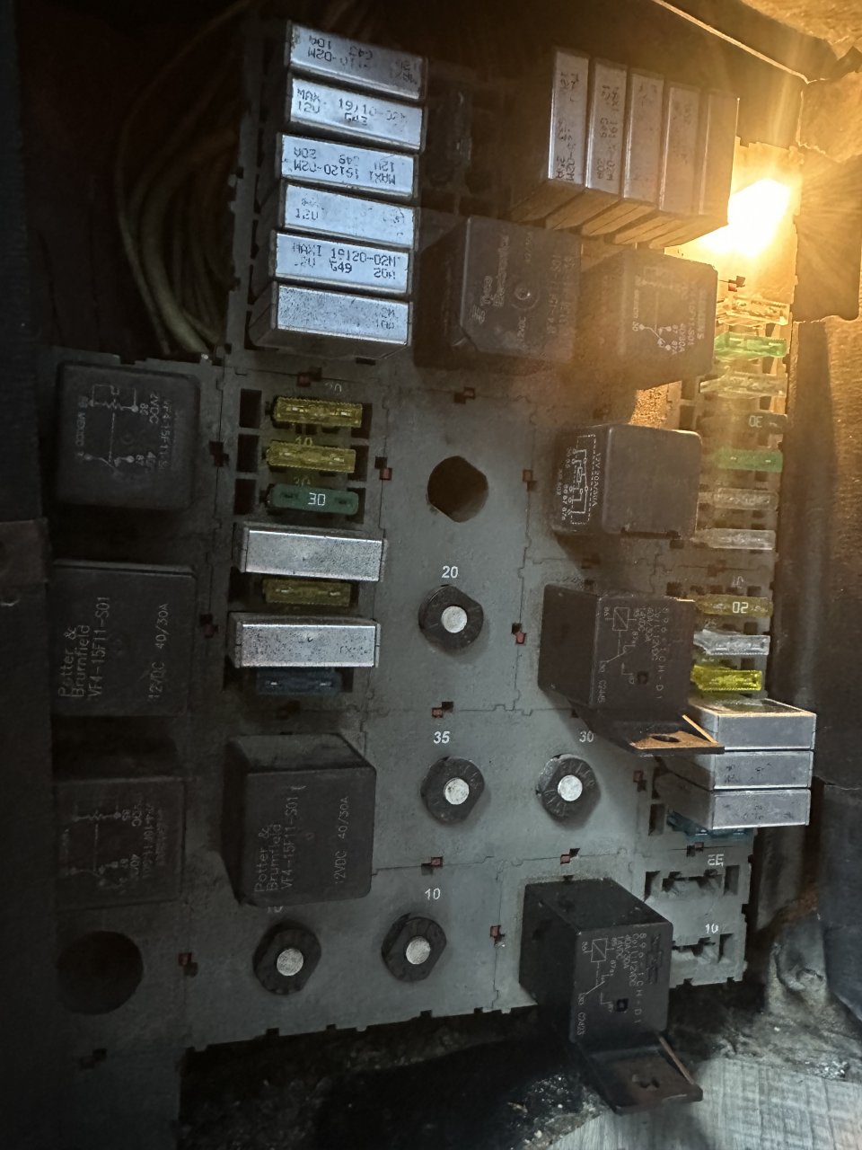

  10. bjytech
    bjytech Light Load Member
    246
    223
    Nov 9, 2013
    You won't find a thermostatic switch on your Peterbilt, they just have 3 switches controlling the clutch relay.
    Low pressure switch → high pressure switch → switch on the control panel.
    In your fuse panel, bottom right side should be 3 relays stacked, from top to bottom those 3 are:
    A/C compressor,
    cab fan low,
    fresh/recirculate air.
    Depending on where the controls are at when the AC is turned on it will activate both the AC comp. And cab fan low relays.
    If you don't have any power at any pins for your AC clutch relay with key on you have a power issue in the fuse box.
    Fuse is the bottom one on the left hand side of the fuse box and it directly feeds both powers you should have on the AC clutch relay.
    Star Rider Thanks this.
  11. Trevor19
    Trevor19 Bobtail Member
    28
    6
    Feb 1, 2023
    attached is a picture of my fuse panel. Something seems to be off. The only relay that I feel click when I press the ac button on/off is the one on the bottom near the right.
    I replaced the fuse you were talking about and it didn’t change anything unfortunately. I was hoping for it to be simple like that since it was working not that long ago.
