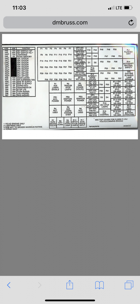

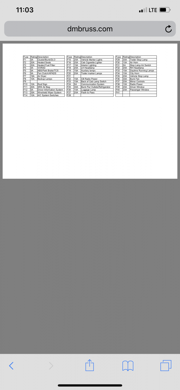

    DD2D80D3-CBE9-4B6D-9685-CB9A499EC728.png 14B2C753-42AE-4A6D-9186-F283B804C88F.png Have you tested every fuse and replaced if bad?
  10. Ciufero
    Ciufero Bobtail Member
    19
    2
    Dec 29, 2018
    I did, fuses OK
