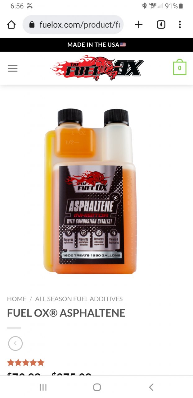

    Your just going to have to run the bad fuel though it and keep changing the fuel filters until it clears up. This stuff helps its expensive but it works after and keeps fuel filters clean. I use it constantly. Screenshot_20221101-185611_Chrome.jpg

    Do you think truck stops have that additive
  10. bad-luck
    bad-luck Road Train Member
    3,491
    6,444
    Nov 16, 2013
    Baltimore, Maryland
    Never have seen any. Google them and give them a call. They are nice people and not pushy
