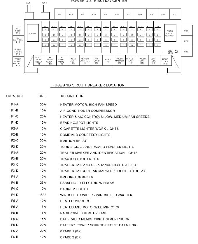

    My glove box doesn't have the diagram for what fuse is what as well as the relays. Any idea which one is the relay I need to check? I've tried to Google it, and I'm coming up empty..thanks
  8. Heavyd
    Heavyd Road Train Member
    7,829
    6,280
    Feb 4, 2009
