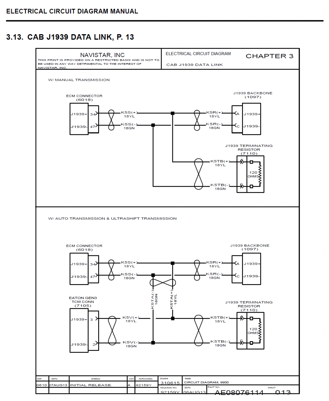

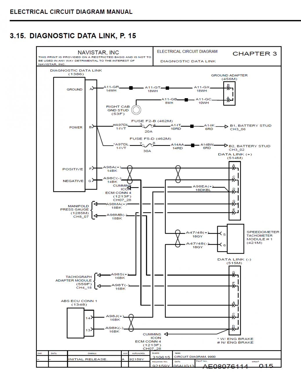

    Datalinks diagrams are completely useless because they only show the basics. Due to all the different configurations I guess there is too many options for them. This is all they have for a diagram.

    This helps because it shows which pins at the ECM are for the data link. My problem started as an "all of a sudden" thing. I have been running this truck for 4 months now. Shut it down Tuesday morning after delivering a load and went to restart and this issue occurred.

    Ok, to add more, the datalink that runs your gauges is a different one, but it very similar to your older truck. The page I uploaded won't help you.
    It looks like the cluster is still feed data by the older 1708 datalink with black twisted wires, not green and yellow twisted 1939.
