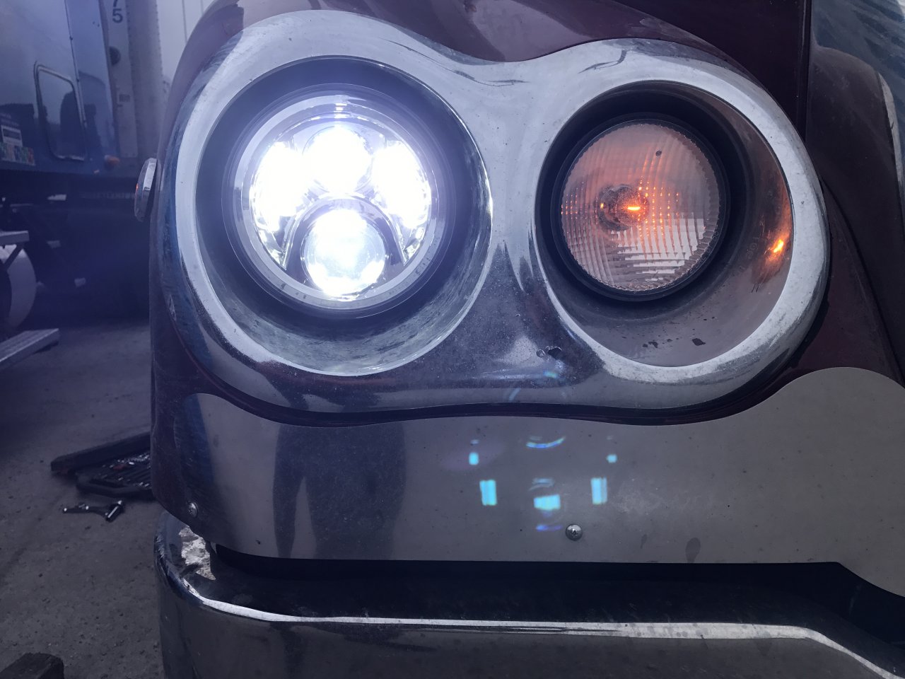

    Here is my work done. Also have a plan to do the same with DTRL/Turn signal lights, found some 5.75 inch size on EBay. A91890D9-CB10-4065-A6D3-4EB1F5AC2425.jpeg

    Very nice! I've found some 5.75 DRL/Turn complete led fixtures that I'd prefer, but I don't have an installation plan yet. The rear, three stud installation that Grote/Freightliner uses on the fixture doesn't lend itself to many aftermarket options. Please post what you work out. Thanks

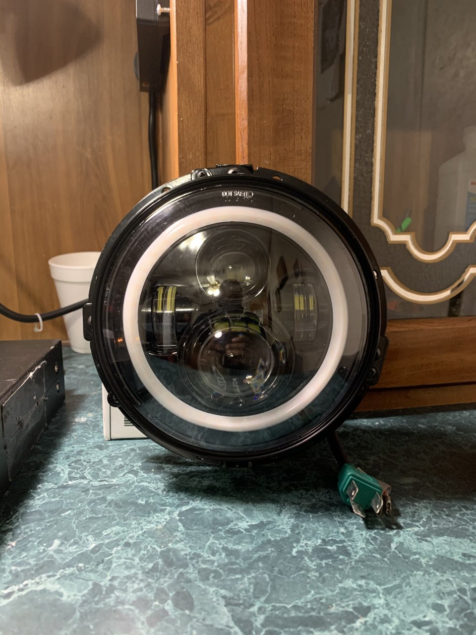

    I have a 2014 Coronado glider with the 9006 & 9005 7” headlights. I have purchased the 7” leds. I had to purchase the plug and play harness off of eBay for the 2 plugs and purchased the Harley Davidson/Jeep cj, wrangler, etc bracket. Will have to do some minor mods on the hood where the headlight goes but nothing major just drill out some holes for the bracket to fit properly.
