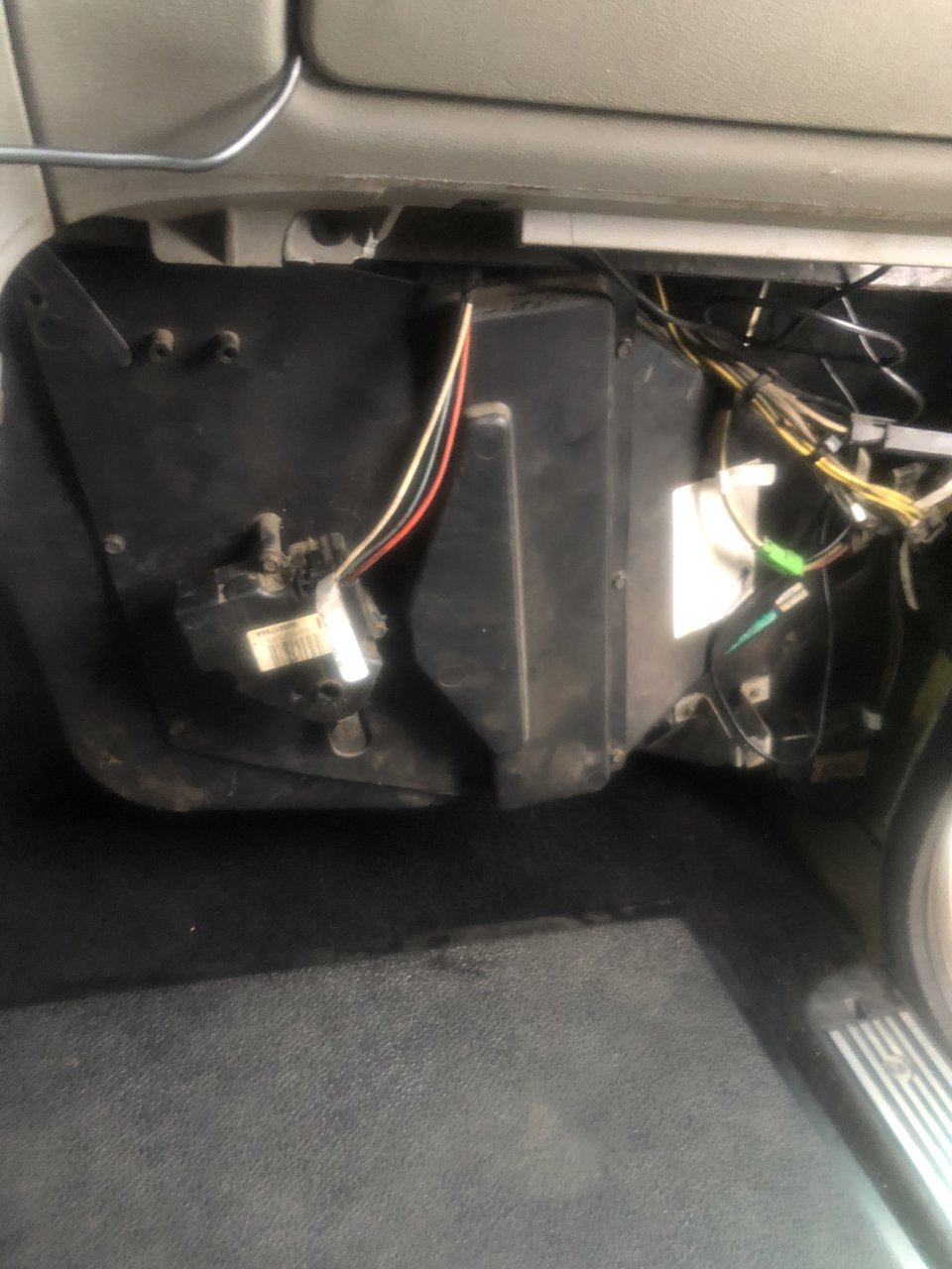

    Ok need a little help , where is the blend door actuator , I locAted 2 underneath the glove box cover but one controls the fresh air /recirculate and the other controls the temp , where is the one that moves the blend door off defrost to vents?

    Did mine quite awhile back. Mine is a 2001 379. Think i had to pull center part of my dash out to locate it, and replace. Yours is probably different would be up to the left from looking at the position of you pic.(if like mine) The two you are showing is pretty much like my 01. See your post is tuesday, mayby you already found it? Hope this helps.
