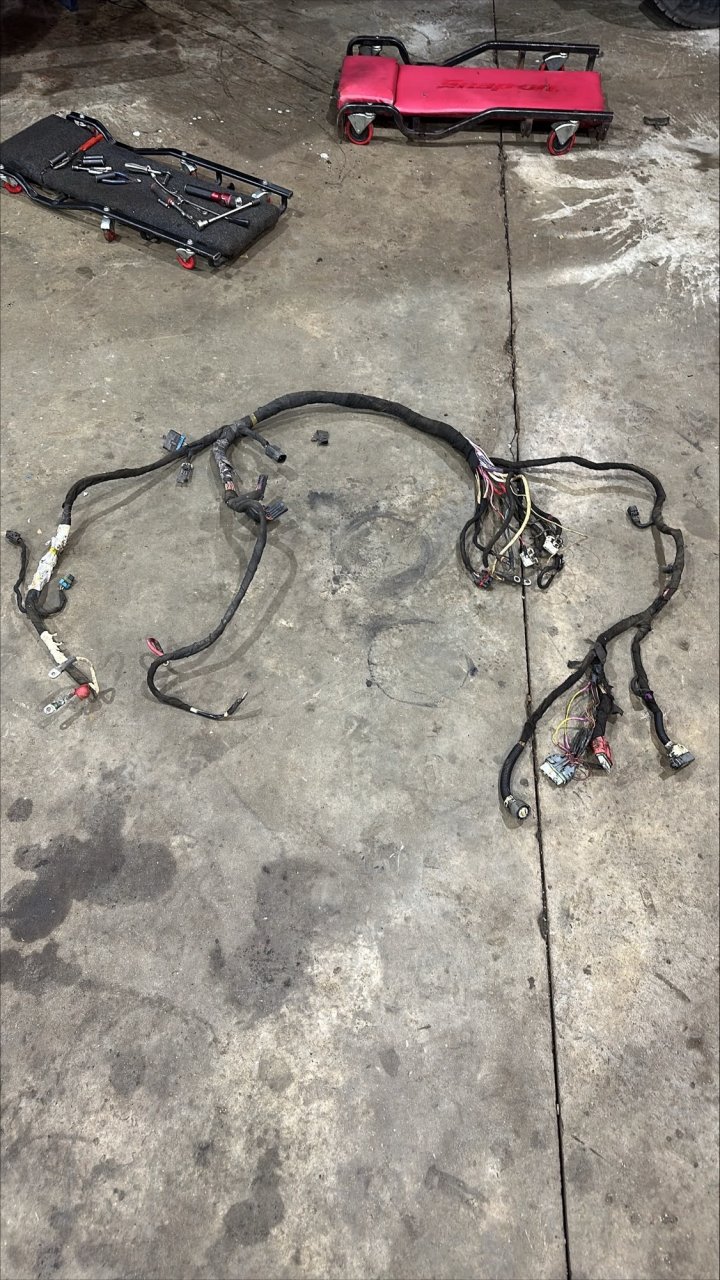

    Hello,
    We have a 06 4300 DT466 w/ Allison trans and are looking to replace the harness that connects transmission, starter, engine. However, we cannot find the correct part # to replace it. You can see below images - Right side is all transmission connections, then it moves up, connects to starter, and goes up and connects to multiple things in engine bay.

    Wire harnesses are made to order. They are not stocked. This would have to be ordered by your VIN by the dealer. Are you saying your local dealer can't help with that? BTW, harness are also very expensive. This will be a few thousand dollars and will take several weeks to make. Also, once you order it, you can't change your mind and you are stuck with it.

    We ordered a $2,000 harness from the dealer w/ our VIN and it had the transmissions connectors (which is what we need) probably about 5 connectors that worked but then it ended with more connectors and didn’t match this all-in one harness. And the dealer can’t find what harness this is, even with the VIN

    They may need to start a Parts Inquiry case file with International for help.
