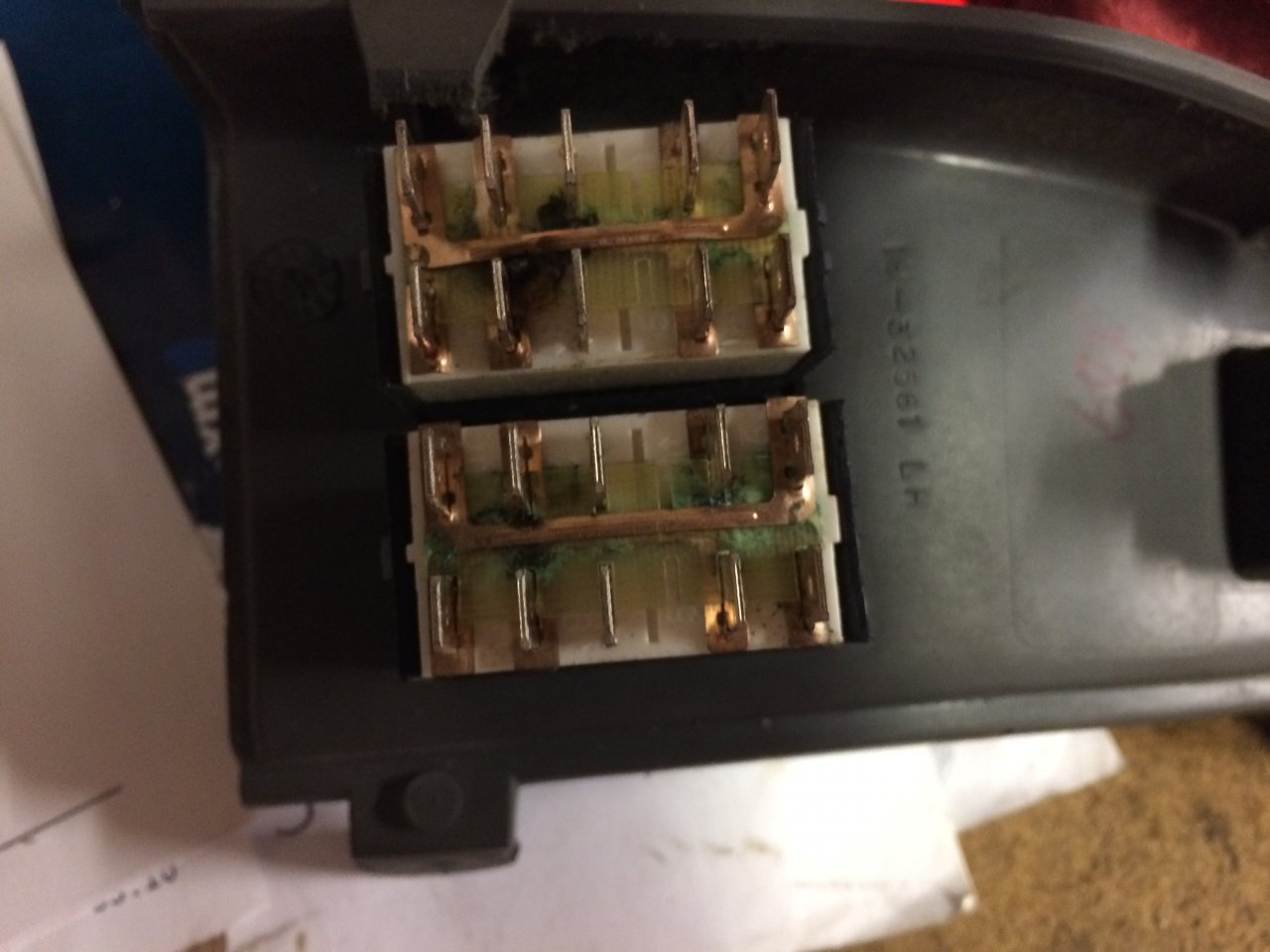

    I have a 2007 Columbia and for some reason the dash lights are on and won't go off even when the light switch is off.
    I checked the six wire plug for the clock power by the passenger side pilar and it was clean with no corrosion at all.
    The dash lights seam to be getting back fed from some where but I don't know where.
    Any help would be great.

    There is a post here from? Chip S? I will tell you tomorrow, maybe? Day cab? Take out the inner panel behind the passenger door. Find the connector lying on the floor with 4 or maybe 6 wires that are all corroded up. Cut them out one at a time, clean them up and reconnect with heat shrink connectors.

    you have a short somewhere in the truck have had this problem numerous times. First thing to check unplug both window switches if you have any on the doors sometime they short out from weather, second place driver door kick panel comes off with three torx and third is small door with electrical connections behind driver seat. GOOD LUCK you are going to need it

    I already had done a forum search and had come across the chip s post about the 6 pin plug by the passenger pilar.
    As I stated in my post the plug was fine and corrosion free.
    So now I will check the window switches.
    Thanks everyone for you responses .
    Keep the ideas coming please .

    Found the driver window switch corroded thanks for the help.
