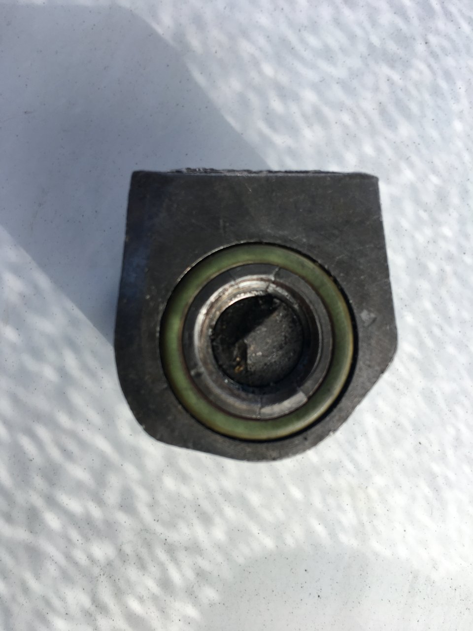

    FB2E38C5-E91F-4872-8443-70B8FE4B1E55.jpeg B411E575-5341-4FCD-943B-9590DB048ADF.jpeg DE9A780E-4F53-420D-8827-D1B46E7E2A37.jpeg Sorry for the late response. There appear to be a small block inside the flywheel housing which the top left mounting stud screws in it. Mine broke off and fell in the housing. I fished it out with a long flexible magnet. Thank God it didn’t cause any damage when it broke off and fell in the housing.
    So I tapped the hole in the housing and screwed a little bigger stud in the hole I tapped, then I put a flatter lock nut and a washer on the other side inside the housing. (Be careful and make sure the clearance between the flywheel and the nut) then I mounted the compressor and tied it down with all three nuts, so far not a single issue with compressor anymore.
    I’m attaching pics of the piece that broke and fell off inside the flywheel housing. Hope this helps and it’s not too late.
