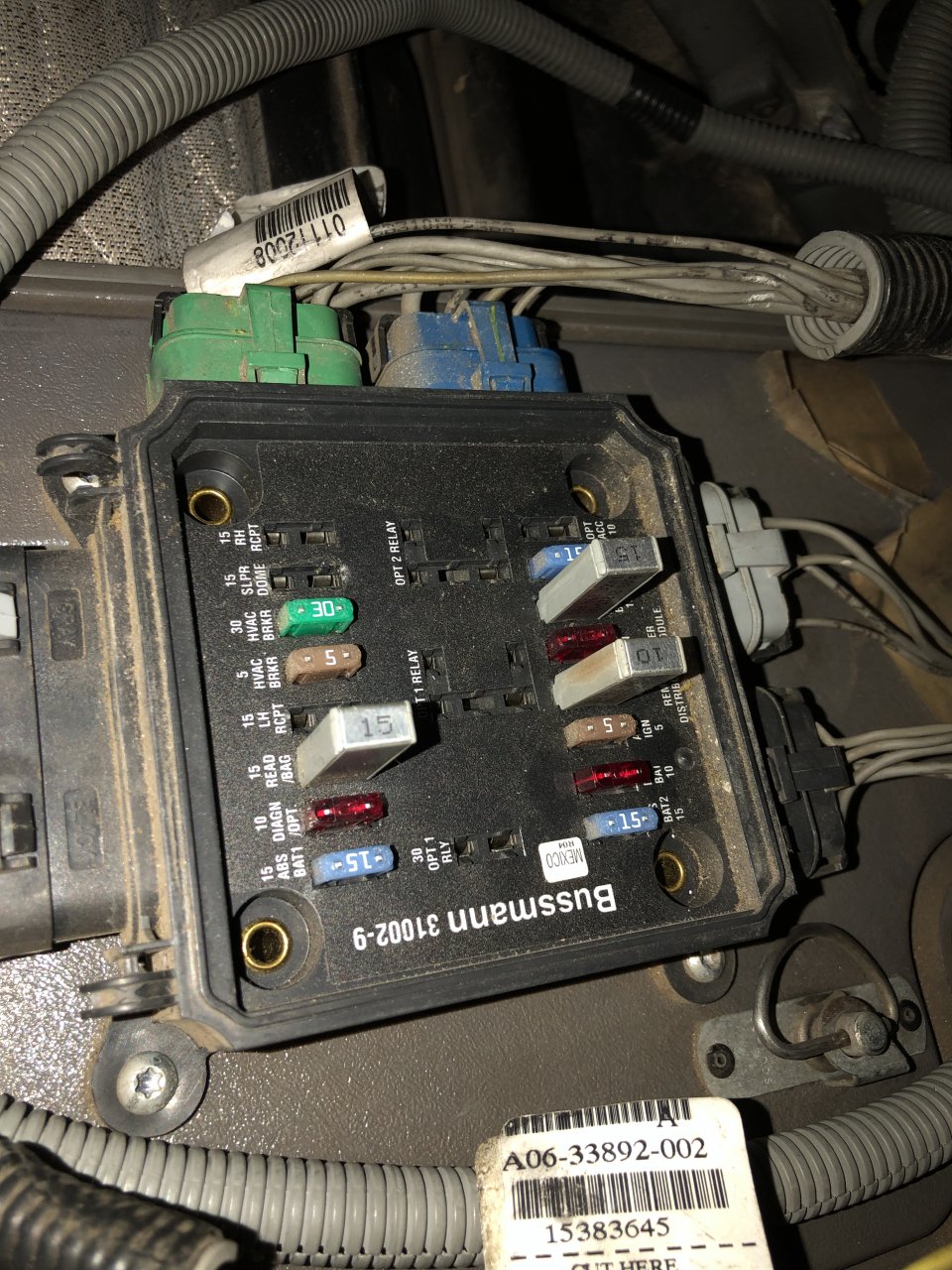

  8. Freightliner575!
    Freightliner575! Bobtail Member
    10
    Jun 26, 2019
    Is this it?
  9. Freightliner575!
    10
    Jun 26, 2019
    This it?
  10. HoneyBadger67
    HoneyBadger67 Road Train Member
    2,056
    4,512
    Dec 15, 2018
    Savannah, TN
    That looks like passenger side. Same place only on driver side.
