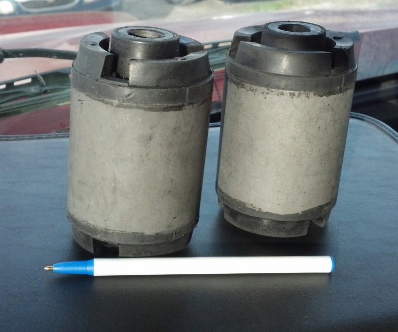

    Volvo 780 cab bushings;
    I'm not saying this is your problem, just bought both for 110$ and have my mechanic replace both sides; after every 300-400k miles this are gone the cab starts shaking and my coffee flying all over on rough roads even with new shocks and good air ride;
