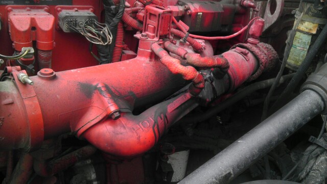

    I've lost turbo boost again. The only active code is for low coolant. My idle is around 900 now. I looked under the hood and now there is a sooty, oily mess around the intake. There is oil sprayed on the block/starter area, also on the the underside of the hood. There are a few good size drops of oil on the frame rail too. I attached a pic. The detail isn't that great. Truck was serviced by Tri State Truck Center. intake.jpg

    Well, the problem got worse and my company got me into a new truck. Where is that coming from?

    most likely that is soot mixed with antifreeze which would explain why sensors act up causing low or no boost

    Your EGR cooler is junk.

    I got to this thread late. But you needed a new exhaust back pressure sensor. Everything was getting backed up with that sensor not reading right. If you had 500k or more on that truck it was definitely due to go bad soon. Probably needed a new doser injector too. With those two going bad it would cause a DPF to plug up pretty quick. And OF COURSE the dealer says its a $$turbo$$.

    Thank you Hope. I'm having this exact problem now. Only difference is I've had the EGR and DPF deleted. I'm gonna give that sensor a shot.

    Check out rawze egr tune up on YouTube. When you replace the exhaust back pressure sensor,clean the metal tube from the exhaust manifold.
