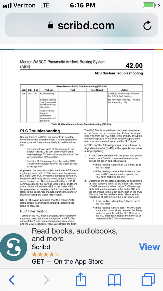

  11. Rideandrepair
    17,584
    56,954
    Aug 8, 2015
    66209FCD-4C1A-41E9-A70D-CFD4C74EB4A6.png I found this on it by googling wabco13635408
