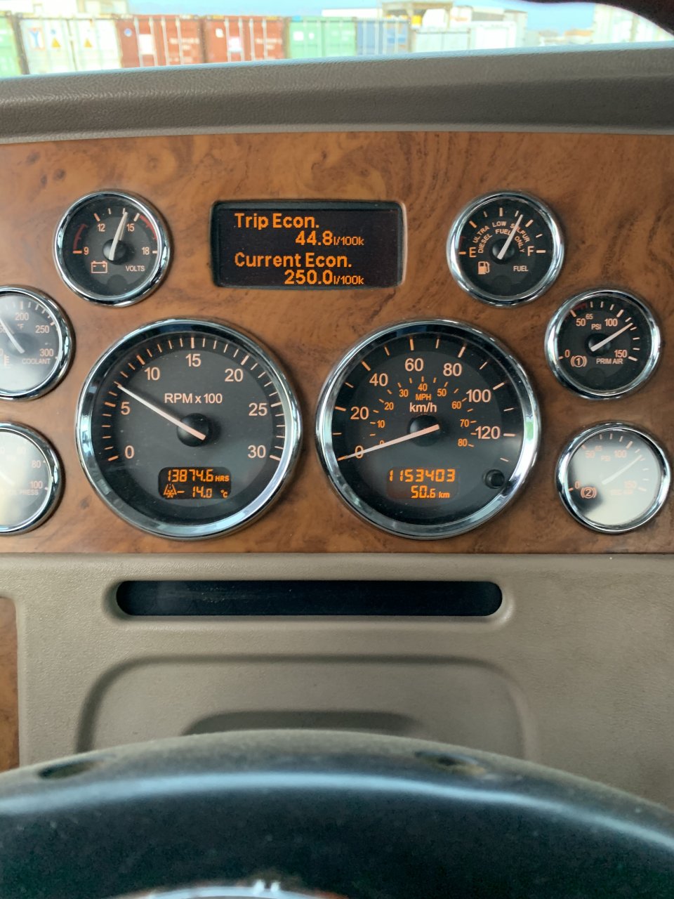

    I have a 2009 peterbilt 367 with a c-13. My dash cuts out at cold temps -15c and colder never in the summer. The dash quickly cuts out and then reboots like you just turned the key on. The truck stays running all my exterior lights stay on and my radio stays on, just the gauges quickly shut down and the lcd display and then reboots. I also notice my trip meter resets to a previous saved reading, eg my trip meter showed 200 kms then the dash does it’s quick shutdown and when it reboots the trip meter will be 78 kms.

    Whats the volt gauge reading when it happens? Is it close to 15v?

    It always sits at 14.5, I haven’t noticed any change before it happens.

    15v will cut out the dash computer.
    If the voltage is fine most likely needs the cecu flashed to the latest version
