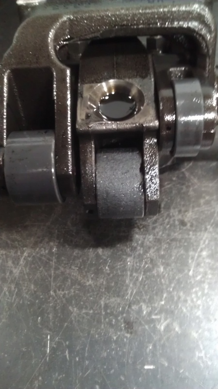

    Put it on the dyno, and it was "only" putting 400hp to the ground. Not terrible for a 515, but it did have a miss.
    Injector cut out test revealed number 5 injector bad.
    Pulled into the shop, pulled the cover,and found the following...
    On, you guessed it....number 5 injector! Not a clue how this happened on a 53k mile motor, but it got tore down last night, and new camshaft will be here today, along with all other bits n pieces needed. The cam has wear on the leading edge, and an actual low spot on the trailing edge, like someone went at it with a Dremel! Dont need calipers, the low spot is @1/16"!
    Thank God for warranty.... We just rolled the truck outside last night, I fired the generator up, and to bed I went with a peaceful mind, knowing the bill is not mine...lol
