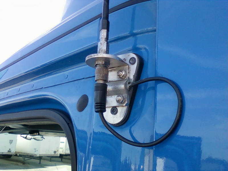

    Here is my solution for now for 2011 Cascadia. Going to try a different antenna at some point. For now using Firestick tuneable, and using a mirror antenna mount bolted to stock mount, ran my own coax around the cab & to radio. Works OK, 1.25 SWR, range 2+ miles.

    That's kind of what I did on this '10, but I went as far as removing the stock antenna and removing the plastic cover over the stock antenna mount. Then I drilled a hole on the bottom of the mount for my own coax to come out and be ran into the cab through the door. Stuck a KB40 whip antenna on that mount and when I went to tune it, the meter was jumping around like crazy when I keyed up but running a ground wire from the mount, along the coax to a screw on the a-pillar fixed that. My SWR's are like 1.5 on channel 1 and 1.8 or so on 40. It's not perfect but I'm probly getting about 3 to 4 miles out of it which is plenty for me.
    I probly still need to do some more fine-tuning to the antenna but I think what I really need is to have my radio peaked and tuned.
