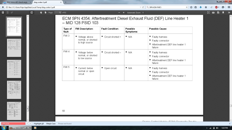

    Why does no one use Google anymore ? it took me longer to make these screen shots then it took to find the information that was asked for. :biggrin_2554:

    On some trucks heated line is of two pices, short and long, so before u order any part - check hose heater resistance. Lines have connectors of different colors and parts gues can identify hose by connector color.
    SCR dosing valve loss of prime - usually low DEF level ore clogged with cristals
    empty DEF tank, fill it with five gallons of water and let truck idle for a half of hour. Drain water and fill it with DEF. Usually removes all crystals
