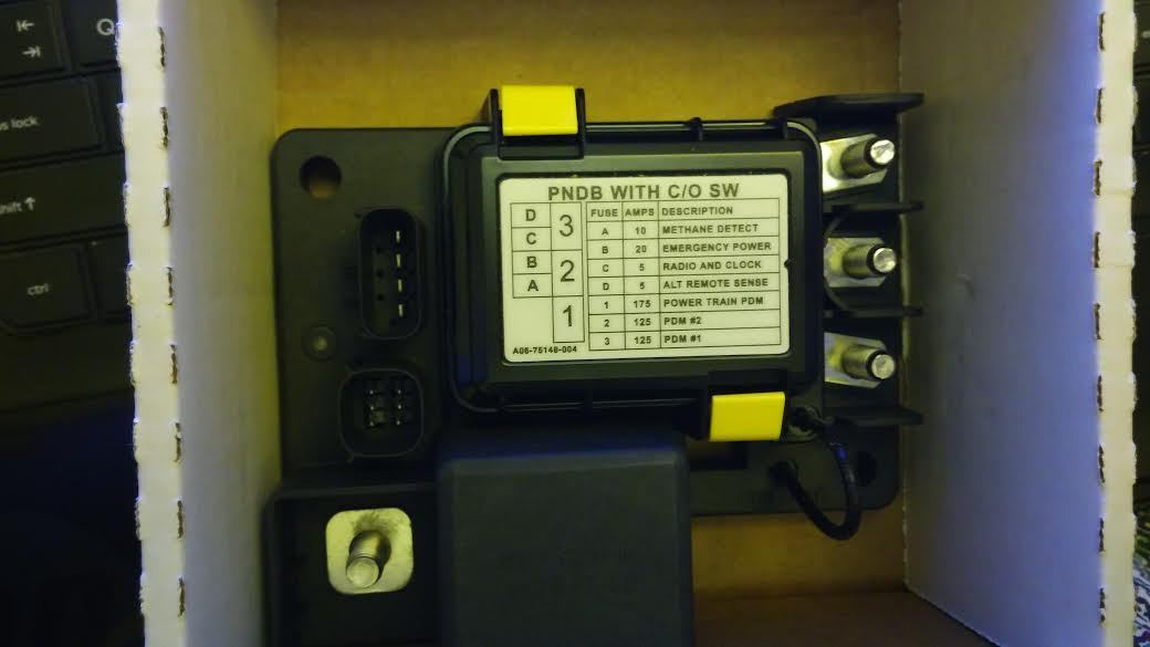

    pndb.jpg must be checked PNDB not PDM .
    check to see fuses are ok inside, check cables on PNDB. check to see LED light is on on PNDB and Power disconnect switch. Now little secret. Check to see your CB radio reset settings after random shut offs. The CB must be connected to original power line. So if CB reset settings then disconnecting happens right there at/in PNDB. CB's 12v power comes straight from PNDB. You can connect bulb on CB power line and monitor it. PNDBs are different for cascadias. If your truck does not have Power disconnect switch the problem will be in different area..

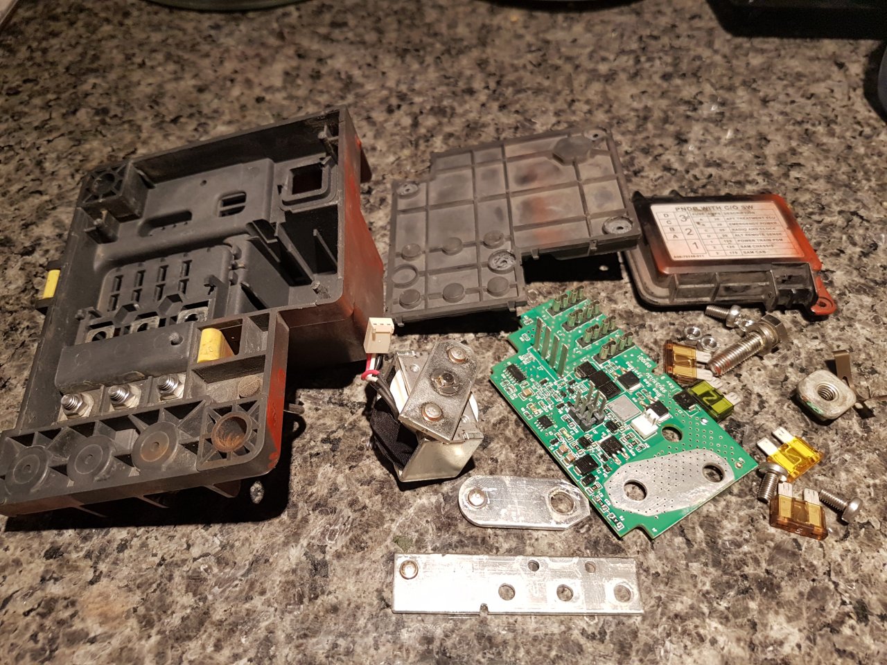

    20170404_002737[1].jpg 20170404_002646[1].jpg 20170404_002620[1].jpg 20170404_002646[1].jpg Hello cascadia Owners
    My truck made me late for today's delivery. It was little foggy morning today in LA. I was heading east on I-210 (near Pasadena, CA) . I was driving and dreaming about good things when suddenly my horse started ######. The truck started randomly shutting off and immediately restarting. After 20-30 second of doing this the truck died. I managed to get off from heavy morning traffic to shoulder. Power was gone completely. I checked PNDB input wire and it had 12v. I had wires in my truck and shorted the input wire to 3 output terminals(1 hour job on shoulder). Power came back and I drove it back to the yard. From another truck took off PNDB and installed on my truck. Called the dealer and they said my PNDB costs $400 and it's a special order( means special junk installed on truck to make people suffer)..
    I like to open failed parts to see why it failed. As we can see contacts are in good shape. I guess one of electronic component failed... My truck's odometer shows 612k now..
