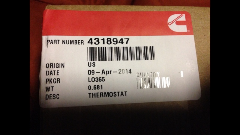

  11. CellNet
    CellNet Light Load Member
    206
    82
    Jun 19, 2011
    Chicago IL
    I am not sure if this will help you, check with the dealer
    Looks like is made it by Cummins:
