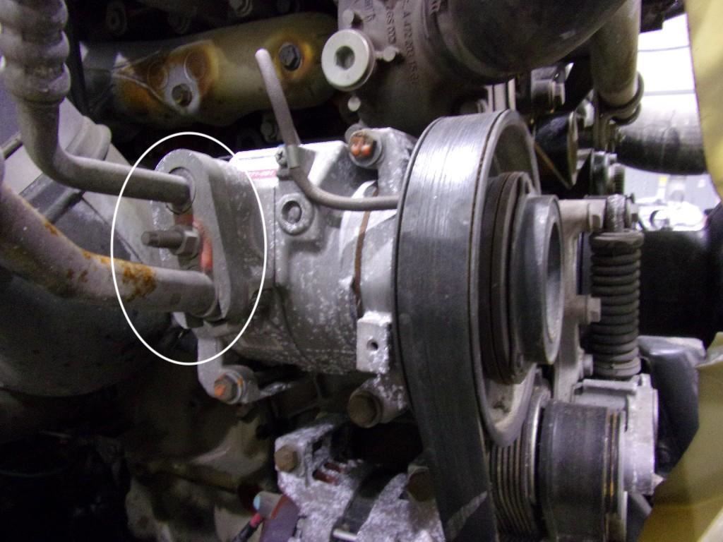

    We have a 2012 Freightliner Cascadia. DD15 engine, last 8 vin is CSBE1267. There is refrigerant leaking from the spot I circled in the picture(from a random website) even we changed the compressor and the seal inside the hose connecting to the compressor twice. I don't understand what else could be wrong. Does anybody have the part number for the oring inside. I want to make sure I put right one in. And torque spec? I also attached a youtube video of replacing the AC compressor so you guys can see the oring inside. But seriously, I am so frustrated because it has run out 3 times and it probably would not last few more days until it breaks again. Any thoughts?

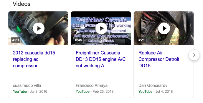

    Video picture(I don't know why I can't browse youtube now, so I just did a screen shot, and it is the first video)
    screen shot.png 2017-FREIGHTLINER-CASCADIA-125-A-C-Compressors-cN11M7VVkEnH_f.jpg

    You might be able to go to FL and buy a part number.
    Or take it to any auto parts store and match it up.
    The o rings are green. And they need to be oiled before installation. With pag oil. Which is also dyed with green.
    If you're doing the work yourself. And not oiling those seals. They tear with the installation process.
    There shouldn't be any trick to finding new seals. They're pretty standard and can be found at any parts stores. Or even a radiator shop. Or find a kit online. Probably off amazon.

    The A/C line could have a hairline crack in it.

    there are special seals on lines under bracket. freighter has them . don't waste your time by searching them in auto part stores. these seals are used on your truck.
    22-68426-000
    22-68427-000
    22-68425-000
    OP I think one of the hoses has small crack ...

    All of these works? or I should use the newest number(the 427 one)? And do you know the part number of the hose? thank you!

    Here is a new photo of the leak, you can see the green place from the bottom tube.

    I gave you 3 p/n. they have different sizes. all of them are for your truck. you cant use them wrong because of sizes. 2 of them goes on compressor lines.
