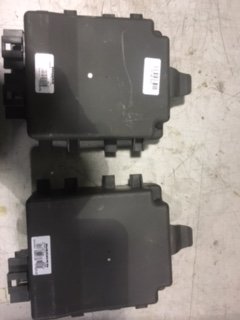

    There are modules in both doors that control power windows/locks.[​IMG]They go bad often.

    I am having the same problem, I called Kenworth too! Lol said the same thing. Just wanted me to bring it in. The driver side window did it first and having a hard time getting the window back up. Now the passengers window went down and won't go back up. When it dries out I am hoping it will. So you say it's the module and do you replace them in both doors?
  8. QUALITYTRUCK
    QUALITYTRUCK Road Train Member
    1,819
    1,784
    Jun 14, 2009
    romulus,mi
    Just the driver door module
