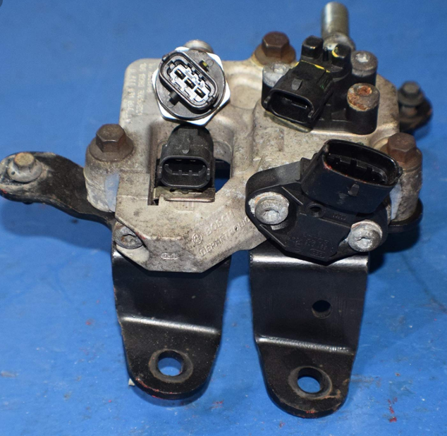

    Would you happen to have a picture of the High-Pressure Control Valve so I can purchase it and have it replace, I believe you are right and that is the problem, since the "mechanic" Lol said it was high pressure.

    Would that be the High pressure valve??

    Nope, that controls the fuel pressure to the doser injector. High pressure control valve is on the back of the high pressure fuel pump. The part with the two main fuel lines at the left front corner of the engine sorta tucked in behind the ecm.

    How about this one?. Sorry to bother you.

    Bingo!
