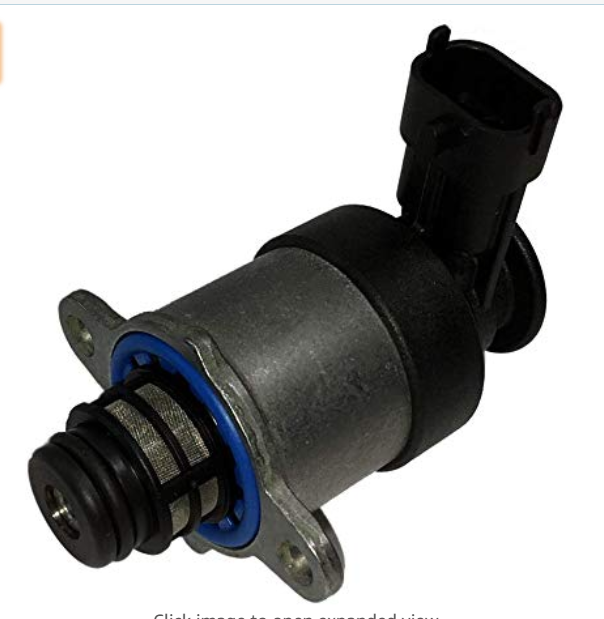

    hello where can I find this valve online to purchase?

    Hey guys, so my situation is weird. I have a 2012 international prostar with the maxxforce 13 engine. Im experiencing loss of power on launch and uphill. You can especially feel the loss of power when loaded with just 10k lbs. my mechanic also mentioned that the engine fault is related to fuel pressure. I’ve been grappling this issue this year and 2018. The guy who I purchased the truck from states that he took it everywhere including an international dealer and nobody can figure out the problem. So im leaning on fuel pump and no i dont want to spend $4000 for replacing fuel pump ill just hold up traffic hauling empty trailers around. Ill just replace the high pressure valve heavyD was talking about here.
    But the weird symptom that I am having with this truck is that when i drive it when i first start it (its an automatic) and when i come to a full stop at a red light the gear stays at 2 and seems to have some power on launch (but obviously not normal power). BUT then after i drive it for a longer and come to a full stop the gears change to 1 and this is where it is extremely low power. It takes A LONG time to reach 35mph. BUT when i see the gear is at 1 and im stopped at the red light, ill turn off the engine and restart it and then its back with a little bit more power and the gear starts on 2.
    guys any thoughts, advice or input would help a brother in need out. Thank you ahead of time

    HeavyD By the way, i ordered what seems to be the fuel limiting valve from the link Eddozer posted. This one on amazon is $42 while the dealer one is $500. Any thoughts on which one to purchase with respect to quality in mind? Im guessing the amazon one is aftermarket

    Is it used? I don't get into parts. I recommend genuine. Lots of counterfeit parts out there. As for your loss of power, your next step is to get it scanned and see what the actual codes are in both the engine and transmission.
