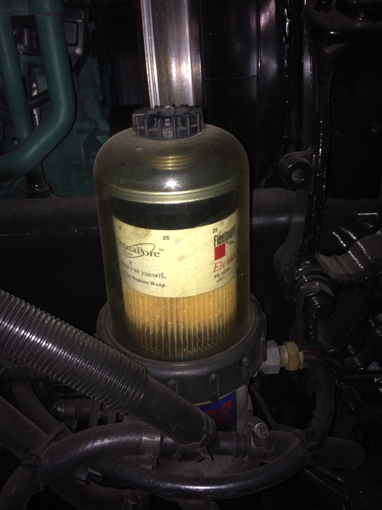

    I see fuel in the second picture, You asked about a vibration and we answered. Are you now asking why the filter seems low to you? We answered that as well.

    I was just wondering is it normal for fuel filter to be black like that at the bottom after five days. If not,maybe it has something to do with shaking.

    Well by your own admission you have had the truck 14 days, what was the filter like before you changed it?

    Thats the old filter. I dont know much about it, but the guy at petro said ot was dirty.

    Ok, well here's the gist on filters. Because it "looks" dirty doesn't mean it is. The way a Davco filter or any filter for that matter works is restriction, meaning the more or further up the fuel goes means the more restriction there is on the filter hence it has to be changed once it gets up to a certain point. That's like saying because your oil "looks " dirty after 5000 miles you should change it. Them so called mechanics at the TA's and Petro's are a hazard to say the least for drivers who don't know the difference.
