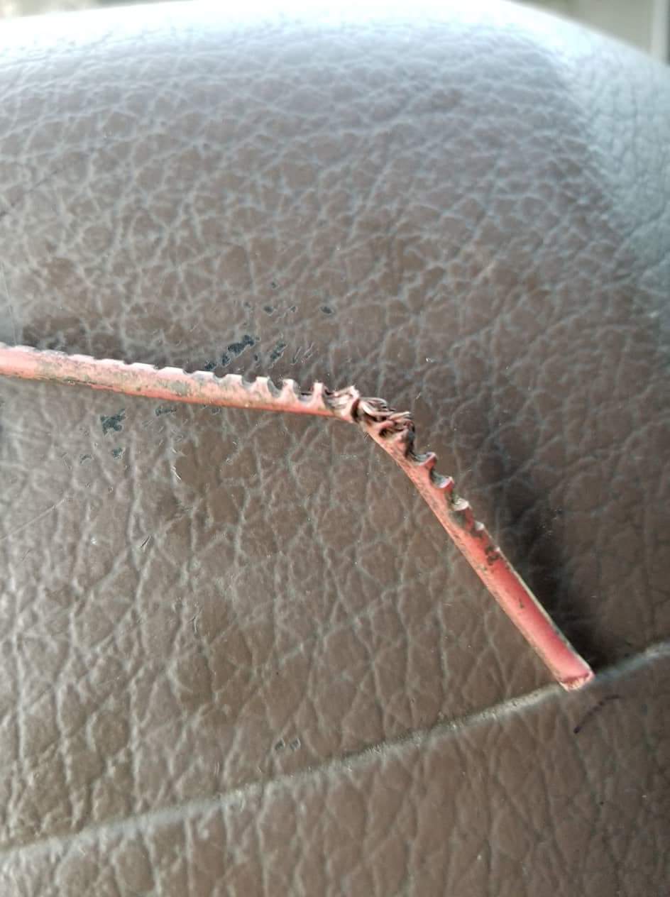

    Red wire was shorted. Looks like the loom material wore thru it where it was zip tied? Only thing I can think of explains all the ridges? FB_IMG_1529427346019.jpg FB_IMG_1529427346019.jpg

    That wire sure looks like it got hot?

    From the picture it looks like someone ziptied it to a bolt?

    Nope, he's right. The plastic wire loom wore through the insulation. I see it all the time. I buy the cloth electrical tape from Volvo. It's $35/roll, but it prevents that from happening again. Wrap all harnesses in the cloth tape and put the loom back on.

    Nope. It leaves the solenoid and dips down then heads up over the Trans. I think he said it joins another loom. Anyway, at the dip where it turns it's inside plastic loom and zip tied right there is where this came from. The ridges on the plastic loom wore into it.

    So Volvo should change the way they secure that wire.
