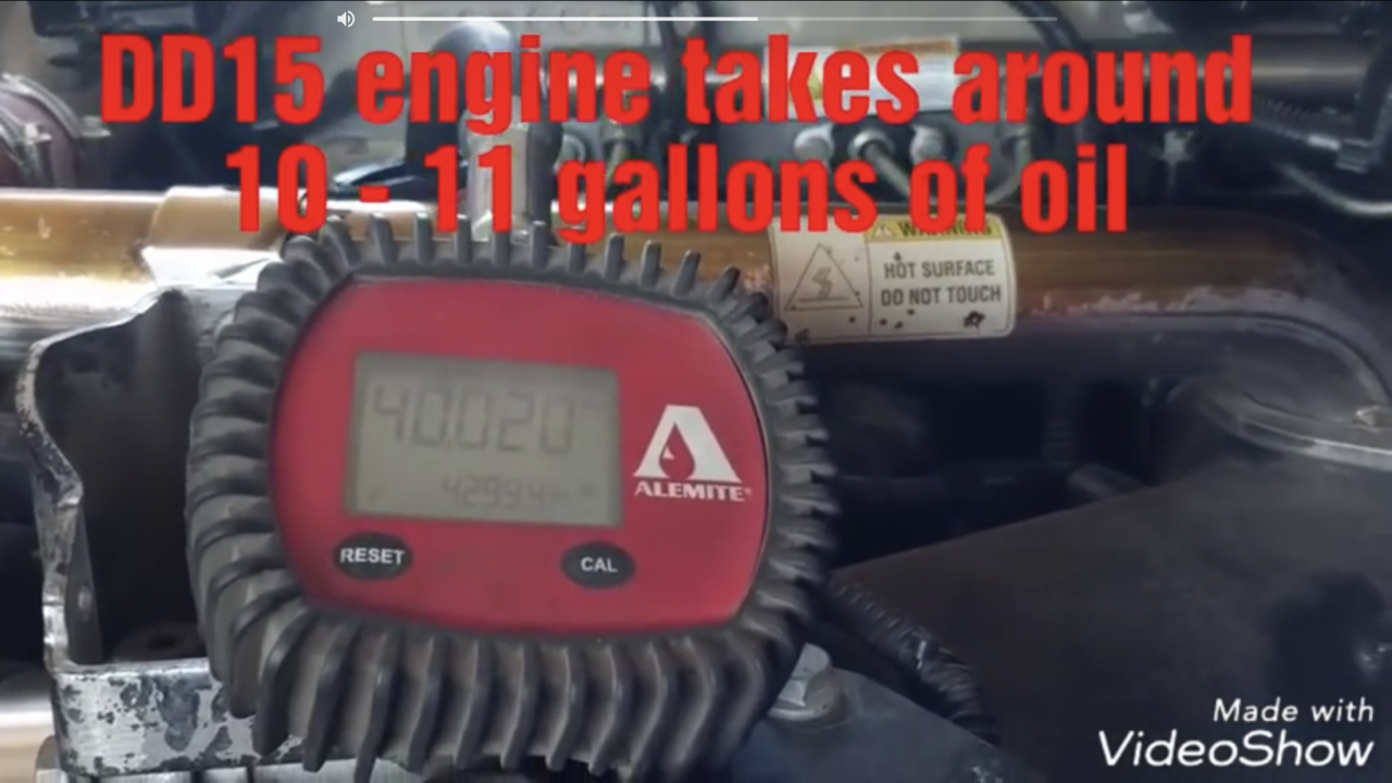

  10. PE_T
    PE_T Road Train Member
    Do you know what this is? It looks like some gauge inside the engine oil.
  11. uncleal13
    uncleal13 Road Train Member
    3,797
    6,299
    Apr 9, 2009
    Humboldt, Sk
    That’s a bulk oil meter. Shops like Speedco have those meters mounted on a hose that pumps new oil into your engine from a large bulk tank, instead of using jugs or pails. They can just set how much oil to pump in.
    PE_T Thanks this.
