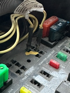

    If Standard, You want to check the clutch switch. I'm not sure about your truck but the cascadia has a starter relay in the PD fuse box.

    My clutch switch is only for jakes and cruise. It’s not anything like a cascadia. This is old school because it’s a glider.

    I found it!! This little MFER was unplugged on one end. I haven’t lifted the skirt off the fuse panel in months. ‍♂️ terminal fits #### tight so I don’t know what happened. F0EA4B70-3B30-4A90-B38E-EC6EA20A1E7B.jpeg

    Electricity Gremlins. Happens all the time. Good you found problem.

    Good deal. Glad you figure it out. Electrical issue on those truck are not easy. Would be good to find wiring diagram on the truck.
