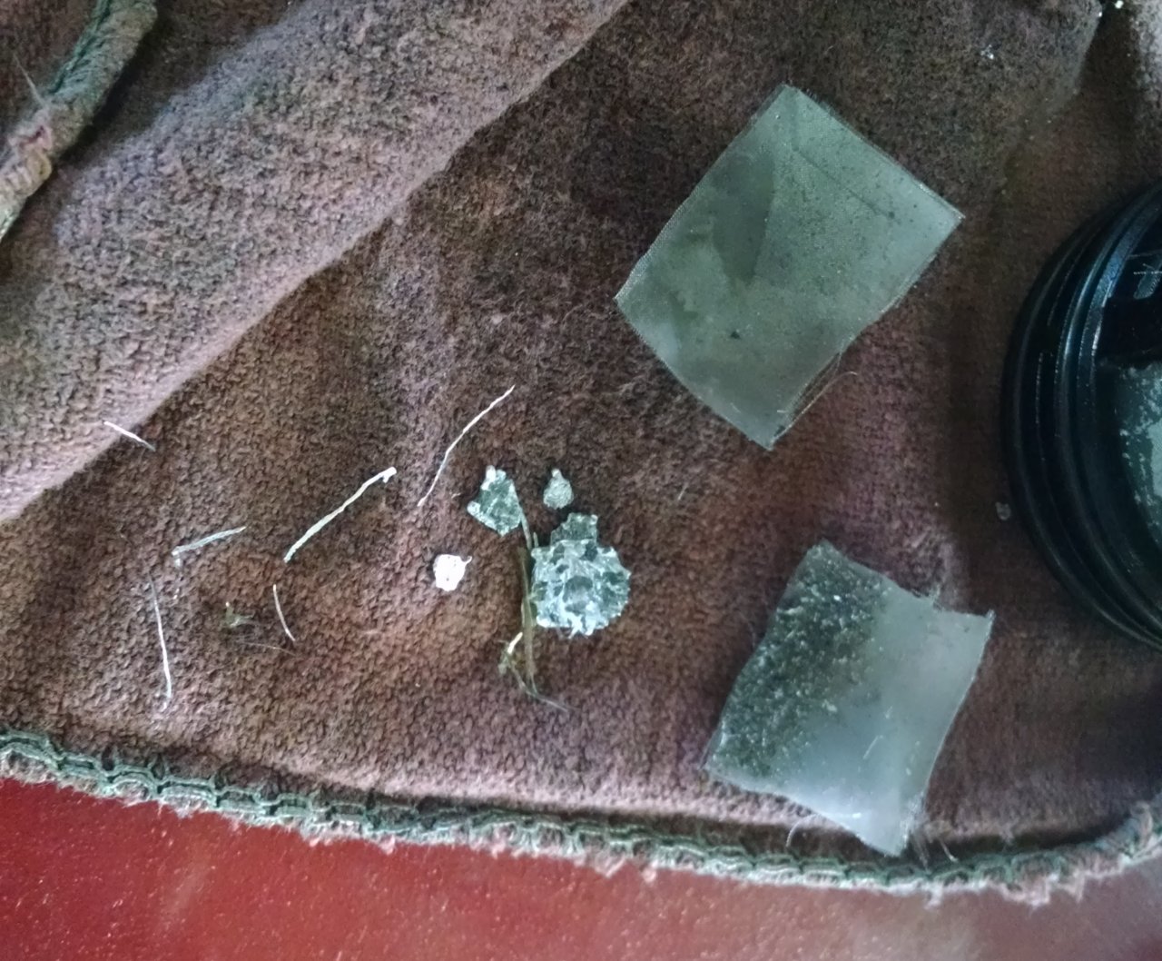

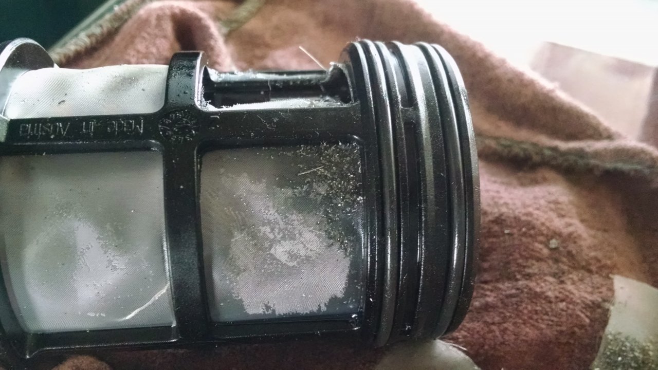

    When was the fuel filter changed last? My guess it's still the original from the manufacturer. When I had the original one taken out of my 2015 it was full of metal debri from manufacturing (See picks below)

    I did a pm at 25000 on mine. Wanted the crate oil out of it and the filters changed out. Don't really trust that the highest quality oil and filters were installed when it was manufactured in Mexico.
