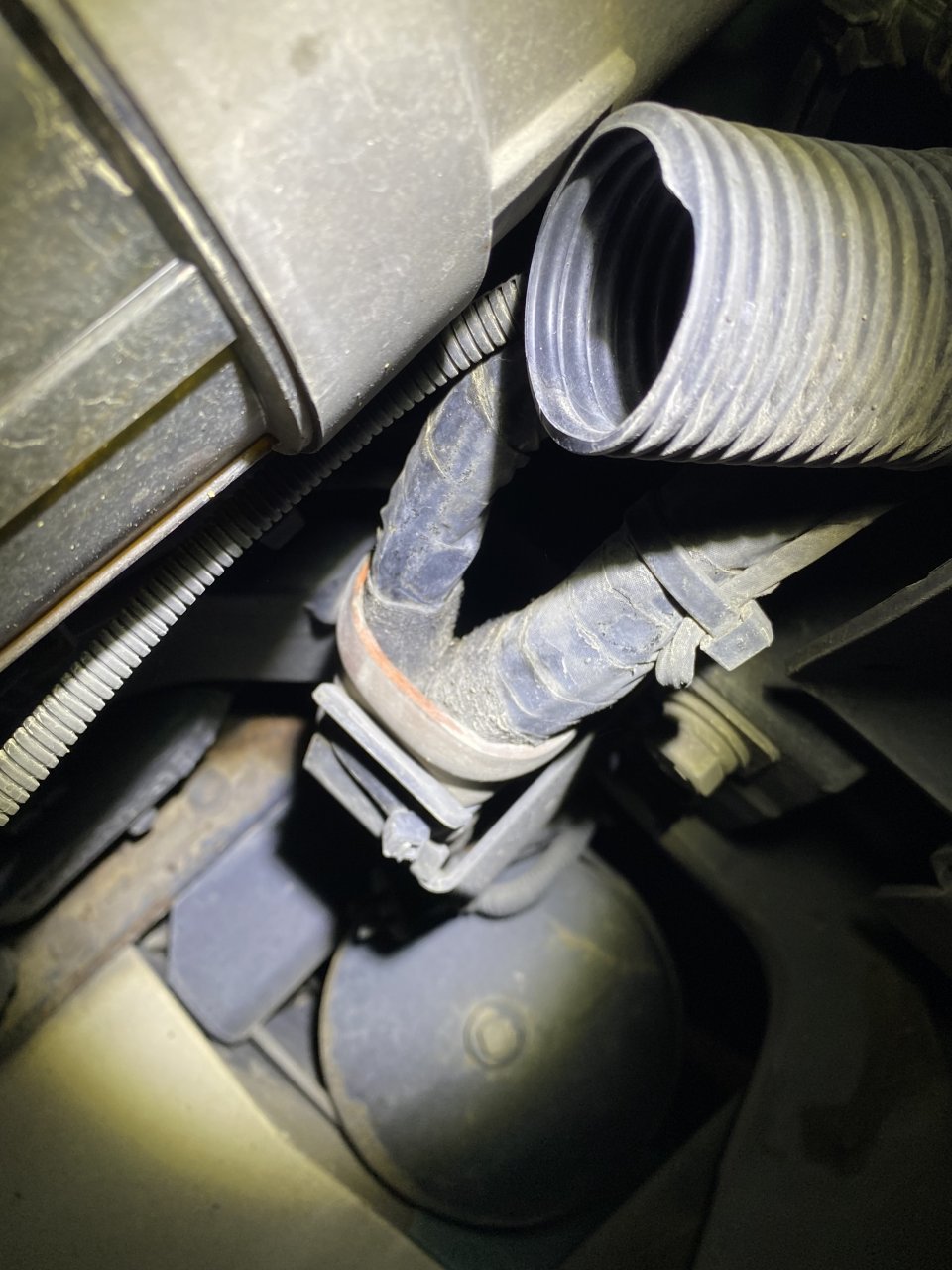

  4. Long FLD
    Long FLD Road Train Member
    12,999
    54,531
    Mar 4, 2015
    I’d start here if you’re having random electrical issues. This is where they have everything bundled after it comes off the firewall and goes under the cab. Cut everything loose and start inspecting for any wires that have rubbed through. I chased electrical issues earlier this year and found 7 wires in these bundles had rubbed through.

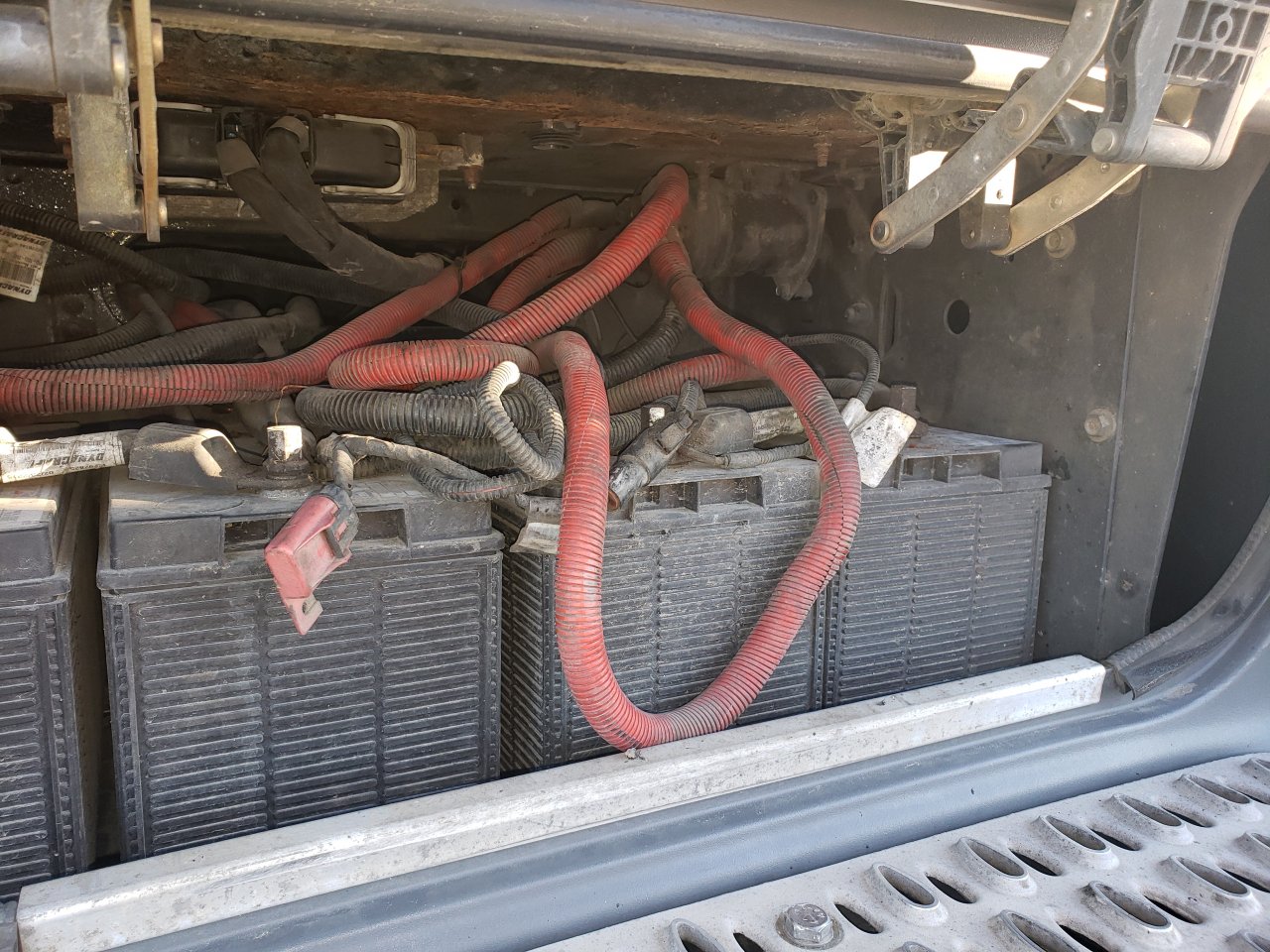

    Do you know what is this part for? It is on my battery box and i cam see there is a lot of corrosion on ir. 20211018_172830.jpg

  7. Long FLD
    12,999
    54,531
    Mar 4, 2015
    Honestly I’m not sure. But it looks like it couldn’t hurt to pull everything off and clean it up good.

  9. Goodysnap
    Goodysnap Road Train Member
    3,784
    9,223
    Jul 12, 2017
    The large starter looking solenoid in the battery box is an electronic battery disconnect switch. Micro control switch is located either behind the driver seat toward the door or behind the sleeper driver side outside near the frame.
