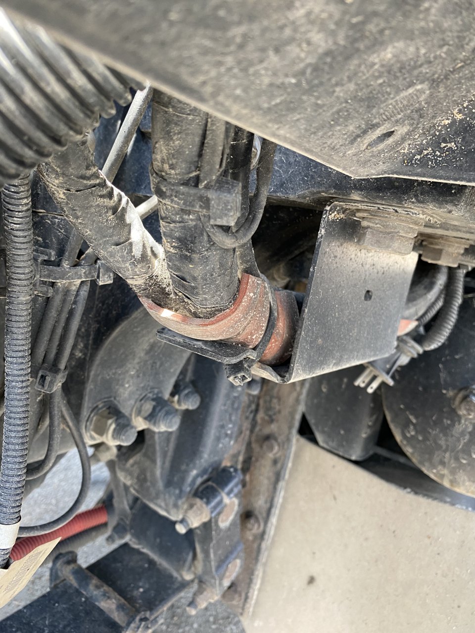

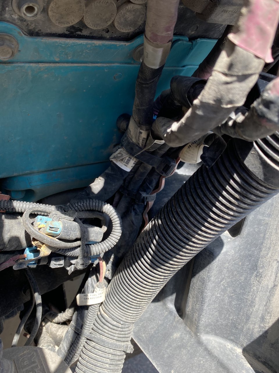

    If that wasn’t your problem then start looking at places like this where they have stuff bundled together from the factory. Cut them loose and start unwrapping everything and checking for where wires have rubbed together.
    1186F17D-44BE-493E-80E4-7A7F89DFDA34.jpeg 8DF14E80-35D6-4037-B6C0-3EEDCCC389A4.jpeg
    Tug Toy and Varinderkahlon Thank this.
