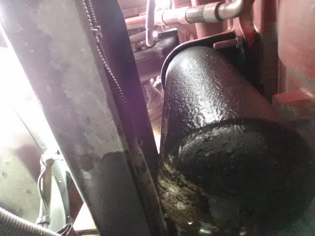

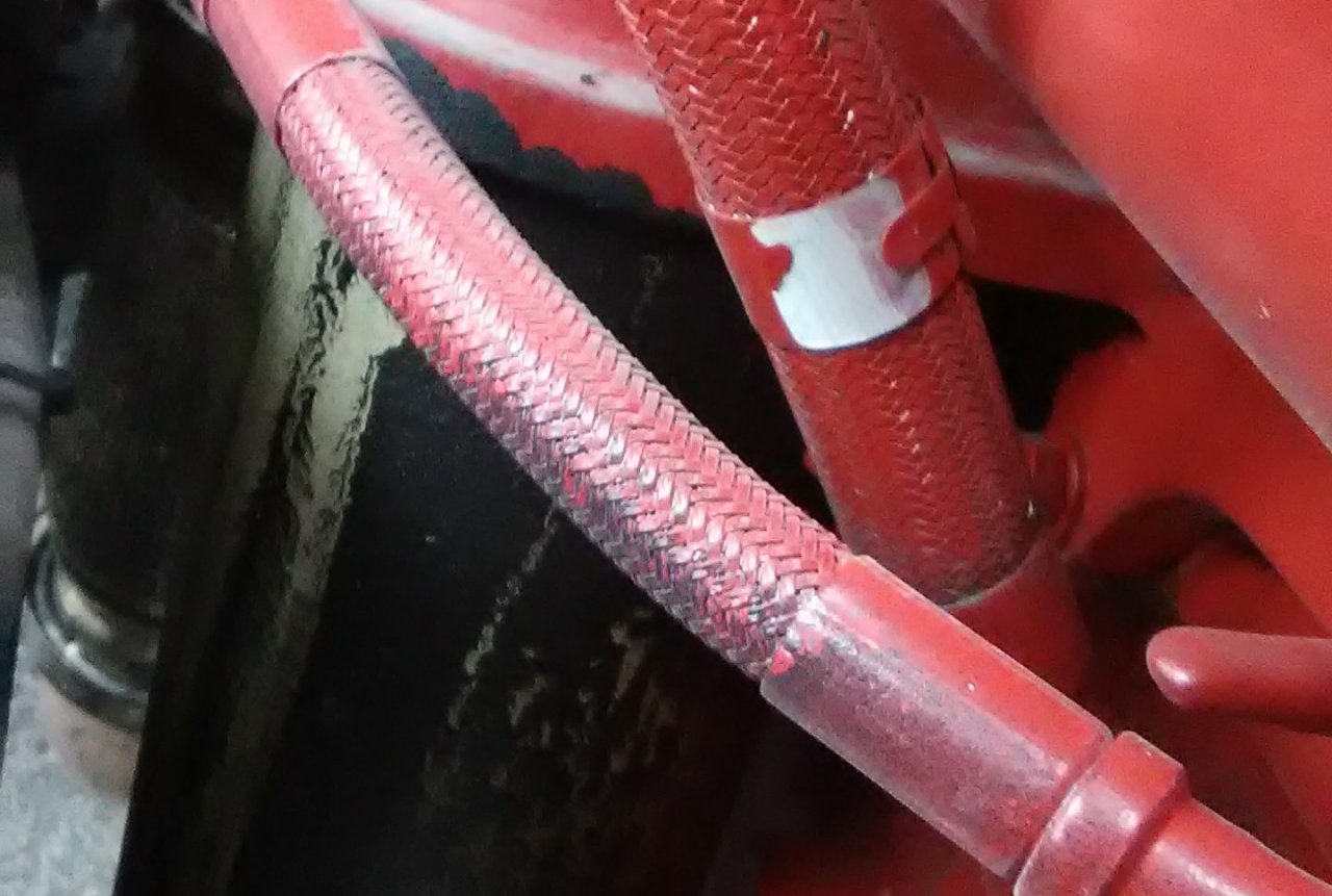

    IMG_20171216_093156.jpg IMG_20171216_093655.jpg Hey everyone. Coming to what MISEIAN said could this be caused by a compression issue. Usually have the truck, trailer, and engine washed before leaving home, didn't this time. Doesn't appear to be a drastic leak but a leak nonetheless. This is a new development I just found doing my PTI.

    Loose oil filter maybe.

    I second that the filter is either loose or has a bad gasket. Had it happen a few times on my old truck. I had one that was loose and needed tightened and the other two times were bad gaskets.

    Regarding the compression issue I mentioned earlier; when your engine is hot and you stop for a break, take the oil fill cap off. You should see some smoke but if it is really rolling out of there it's a sign of compression loss as well or blow by as they call it. Oil samples are cheap and if your sample comes back high in certain metals, soot, fuel dilution, etc it tells you exactly where the problem is. Any speedco, dealer, and maybe TA/Petro could pull a sample. I send mine to Blackstone Labs. Speedco can analyze it right there on the spot but I've heard their machines aren't very accurate.
