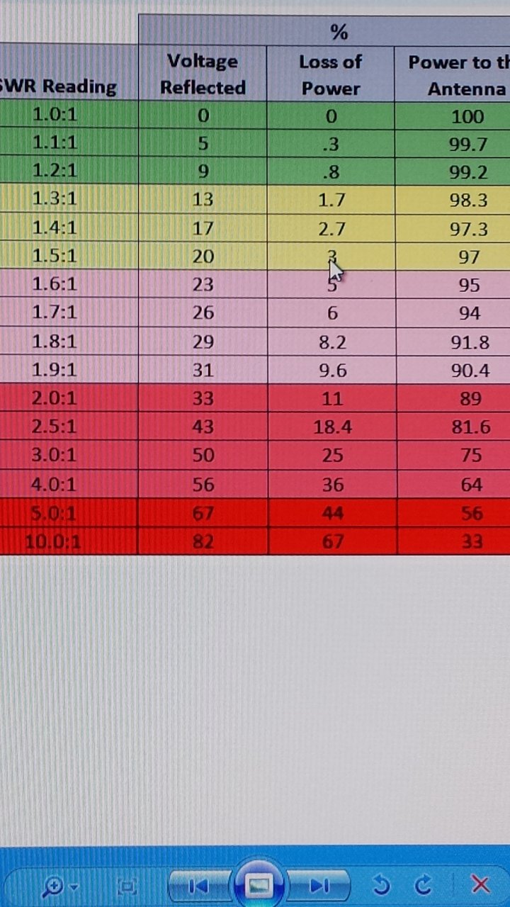

  6. craig_sez
    craig_sez Road Train Member
    5,570
    2,714
    Sep 5, 2013
    novascotia,Canada
    Slow mover....Notice the diff,look at all that loss and reflected into your radio....Yes resonance is a good plan but where is the resistance....Your ant god has skipped a step..
