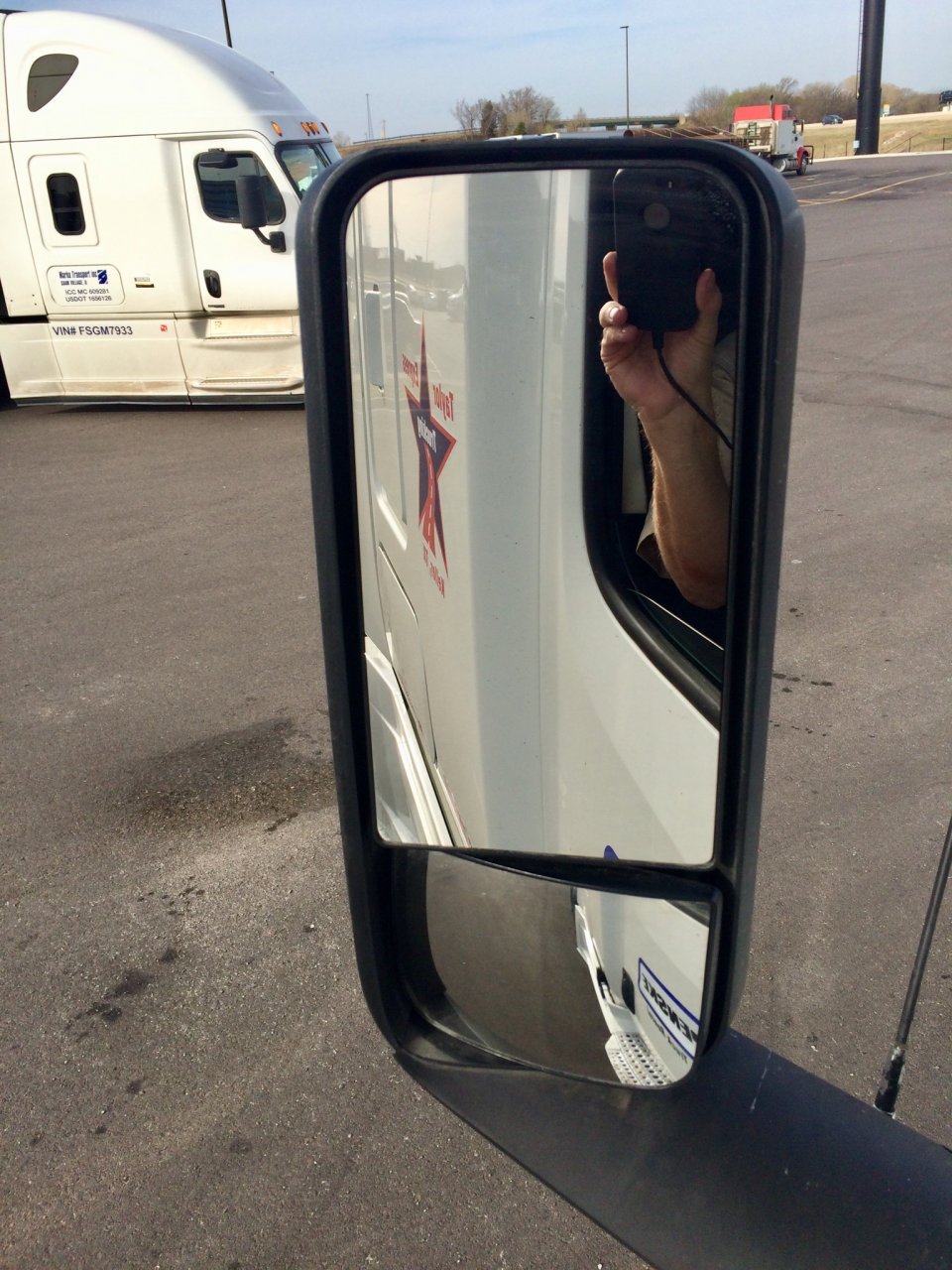

  5. Slowmover1
    Slowmover1 Road Train Member
    1,491
    1,210
    Oct 25, 2015
    Fort Worth
    Hey, Mike5511. Thx for those tips.
    Photo isnt great, but . . . .
    On this 2018 the mirror housing doesn’t extend far enough out from the glass to slip the vise-grips onto any portion (the upper and inner only ones acceptable).
    Were the glass evenly recessed all around, there’s still virtually no recess on any portion.
    The top of that housing is a good six inches or lower than the visor.

  7. mike5511
    mike5511 Road Train Member
    3,156
    1,546
    May 15, 2011
    NW Arkansas
    I used the needle nose vice grips and ground the bottom jaw down. That mirror doesn't look any different than the one on the 2016 and below. Put a piece of fuel line on the top jaw, and you can clamp without leaving a mark. Like I said, you won't be able to adjust the mirror while the vice grips are in place.
  8. Slowmover1
    1,491
    1,210
    Oct 25, 2015
    Fort Worth
    Thanks. Didn’t think of needle-nose in looking at it. Or fuel line.
