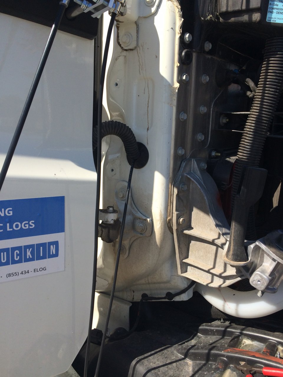

    Drivers side coax run. Same as before with co-phase now. Up under wiper on edge of firewall. But, . . .

  3. Slowmover1
    Slowmover1 Road Train Member
    1,491
    1,210
    Oct 25, 2015
    Fort Worth
    . . as shown on Passenger side is the way to do it: Remove fender cover. Unplug lamp. Run thru door wire-run grommet.

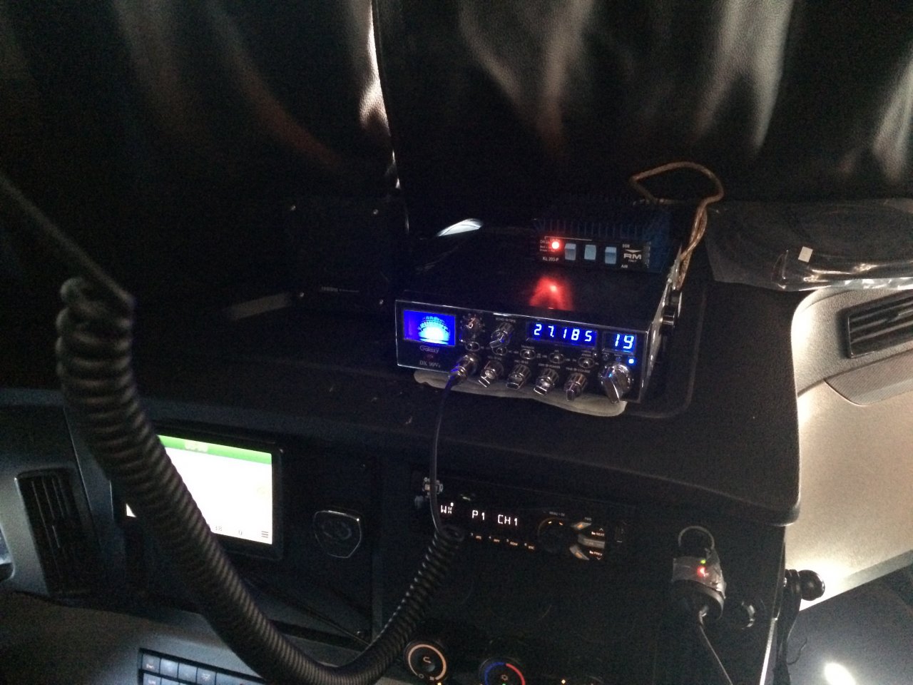

  4. Slowmover1
    1,491
    1,210
    Oct 25, 2015
    Fort Worth
    Power as before. Except run thru dash lower. From BATT thru floorboard, up A-pillar. Recommend across dashtop for ease. Room to clear defroster vents at windshield base.
    (Remove entry plate. Lift floor cover. See taped hole in floorboard a few inches in).
  5. Slowmover1
    1,491
    1,210
    Oct 25, 2015
    Fort Worth
    Found I’d left my 99V2 at Clays several years ago. Had only had it a few months. Thought I’d lost during a move, after a hospitalization. A bad time.
    Had him check over that KL203 would run right with it.
    Great receiver.

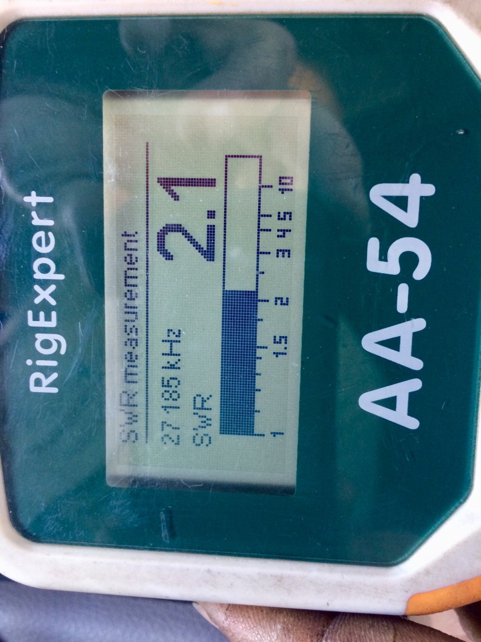

    On the RigExpert, SWR is good.

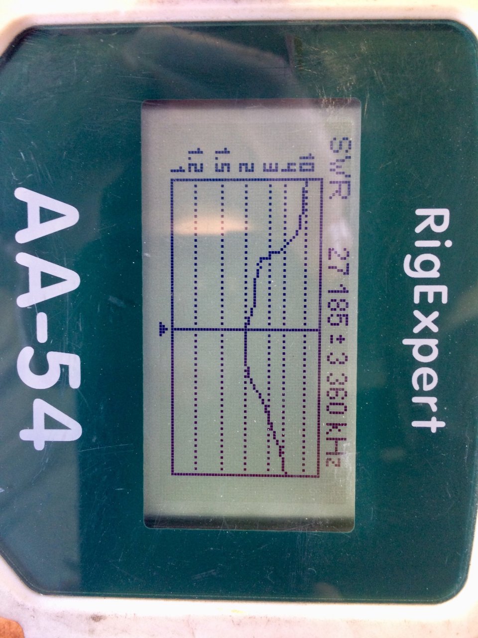

  7. Slowmover1
    1,491
    1,210
    Oct 25, 2015
    Fort Worth
    And it’s a broad-banded son. The antennas are tilted forward now about 20-degrees.
    Road testing will have to wait till 34-over.

  11. craig_sez
    craig_sez Road Train Member
    5,570
    2,714
    Sep 5, 2013
    novascotia,Canada
    I would be worried that the metal will in time cut or ground out that coax there..
