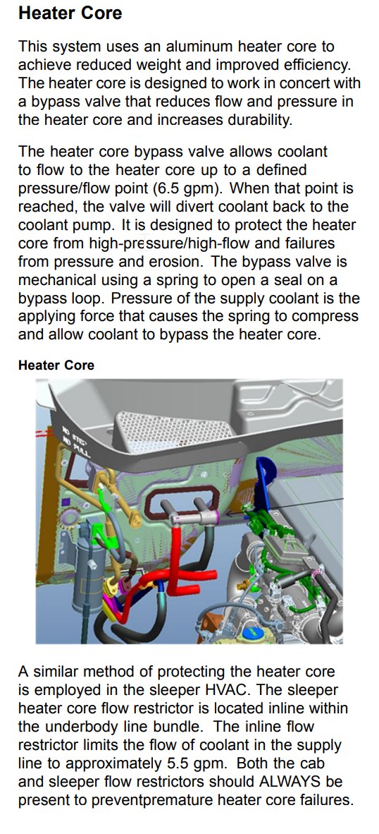

    Did you actually do the hvac actuator test with ESA where it lists off all the actuators and a pass/fail? Checking codes is not good enough,
    Are the hoses heading to the heater core hot? Are they hooked up the right way? It does have a coolant bypass valve on it that can fail.

    Nice diagram well to be honest you are correct I don’t think the pass fail test was done I need to look into that I can borrow the laptop tomorrow from my friend and see if I can do that test yes the valve I’ve replaced 2 times another note for the sleeper is there a separate heatercore or lines or they are ran together from the main heatercore and yes both those hoses are super hot to the touch the in and return

    Those heater flow restrictors and bypass valves mentioned in the diagram seem awful suspect. Your getting warmer air, when you rev the engine, indicates a water flow problem.
