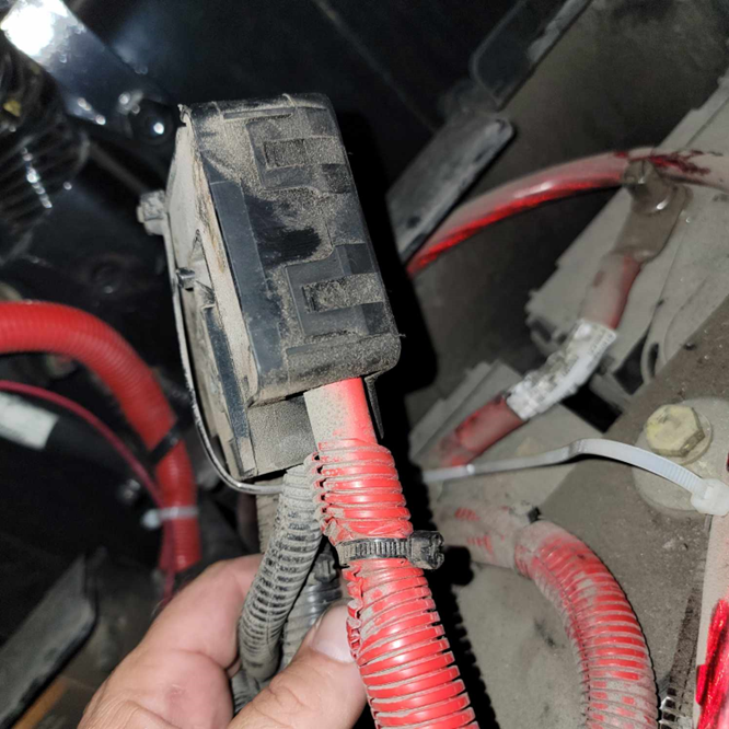

    I had him make sure that all his accessories were turned off as well as 2 inverters he has plugged into a lighter adapter, when I was a dealer tech we had vehicles all the time coming in with dead batteries and the only parasitic load I would find was their phone chargers plugged into the lighter port. On battery #4 there's a black plastic box with a battery cable going into it and one exiting along with what he thinks are grounds. Any idea what that is? I can get him to send me a picture of it if needed.

  11. RC6069
    RC6069 Bobtail Member
    6
    Nov 6, 2022
    Here's a picture of the box I had mentioned, it may just be a junction block but I haven't looked at it directly myself. I asked him to cut the wire tie and take a picture of the inside.
