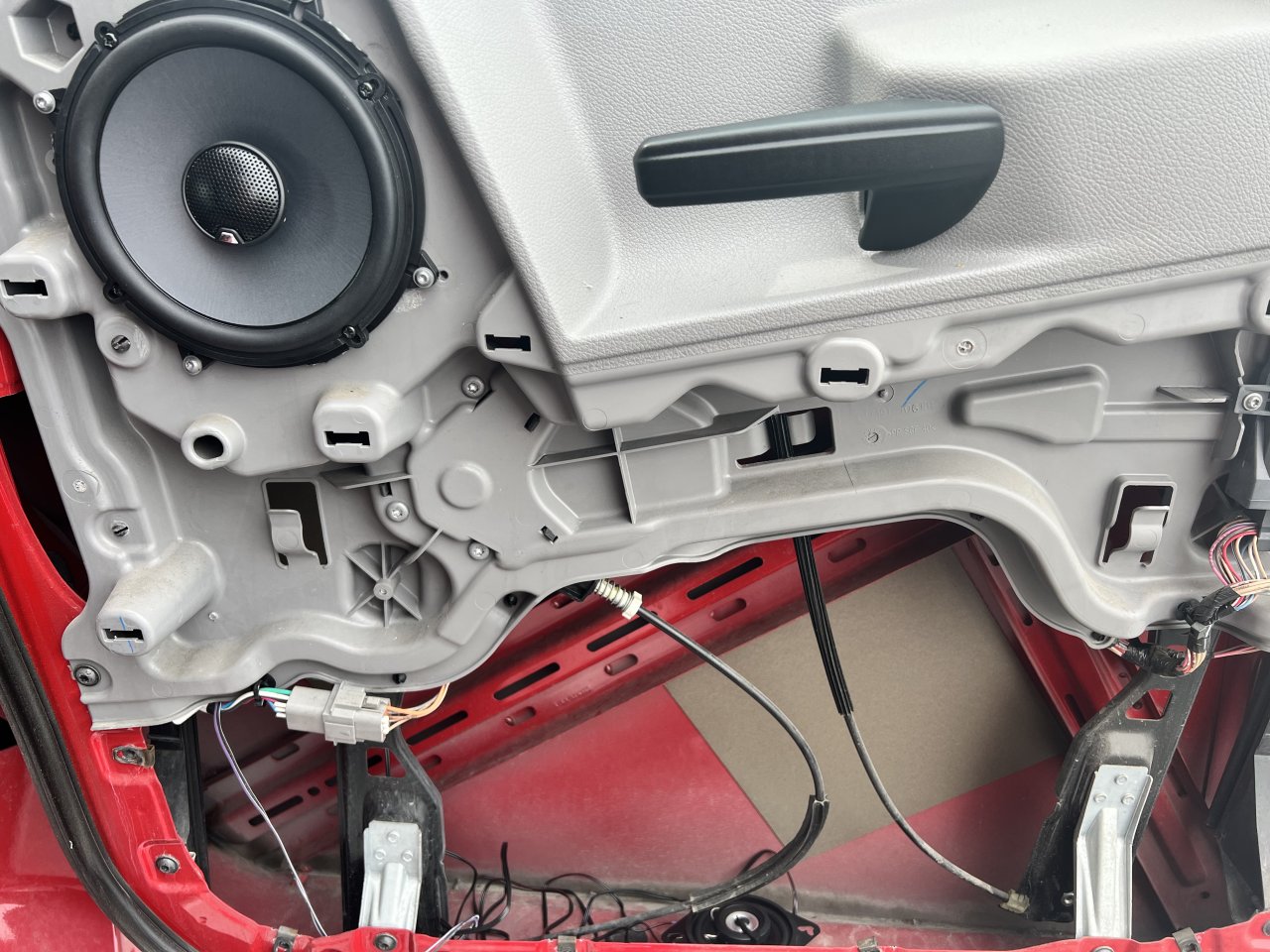

I recently upgraded my speakers in my 2018 P4 cascadia 126, or new cascadia as some call it. There was a lot of trial and error involved and i hope to save any one considering changing their speakers a headache.

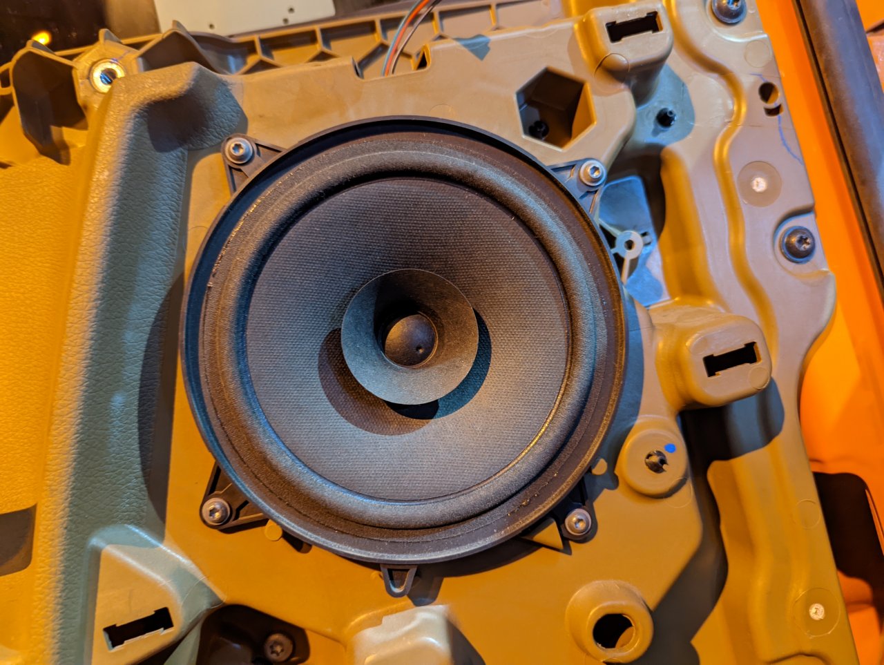

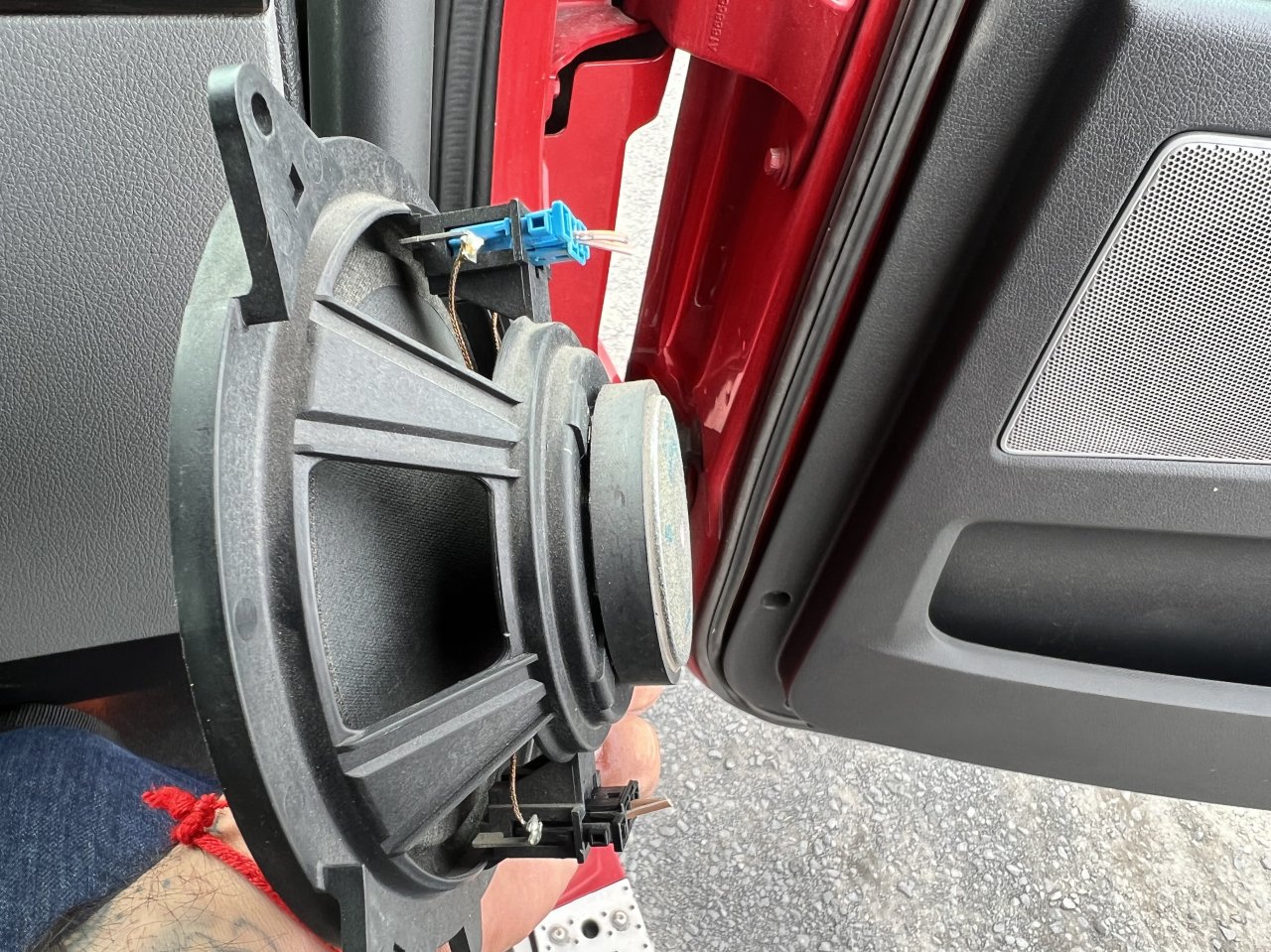

Stock door speakers are 6.5 inch and they have two harnesses attached to them. The blue one is for LDW and other truck sounds like blinkers and other beeps and buzzers. The black harness is for the stereo.
Cutting, stripping and combining both sets of wires together won’t get you any sound. If you only wire the stereo sound to the speaker you get the dreaded “speaker problem detected” as well as a “service Lane departure warning system soon” warnings. Tweeters won’t work for the blue harness either.

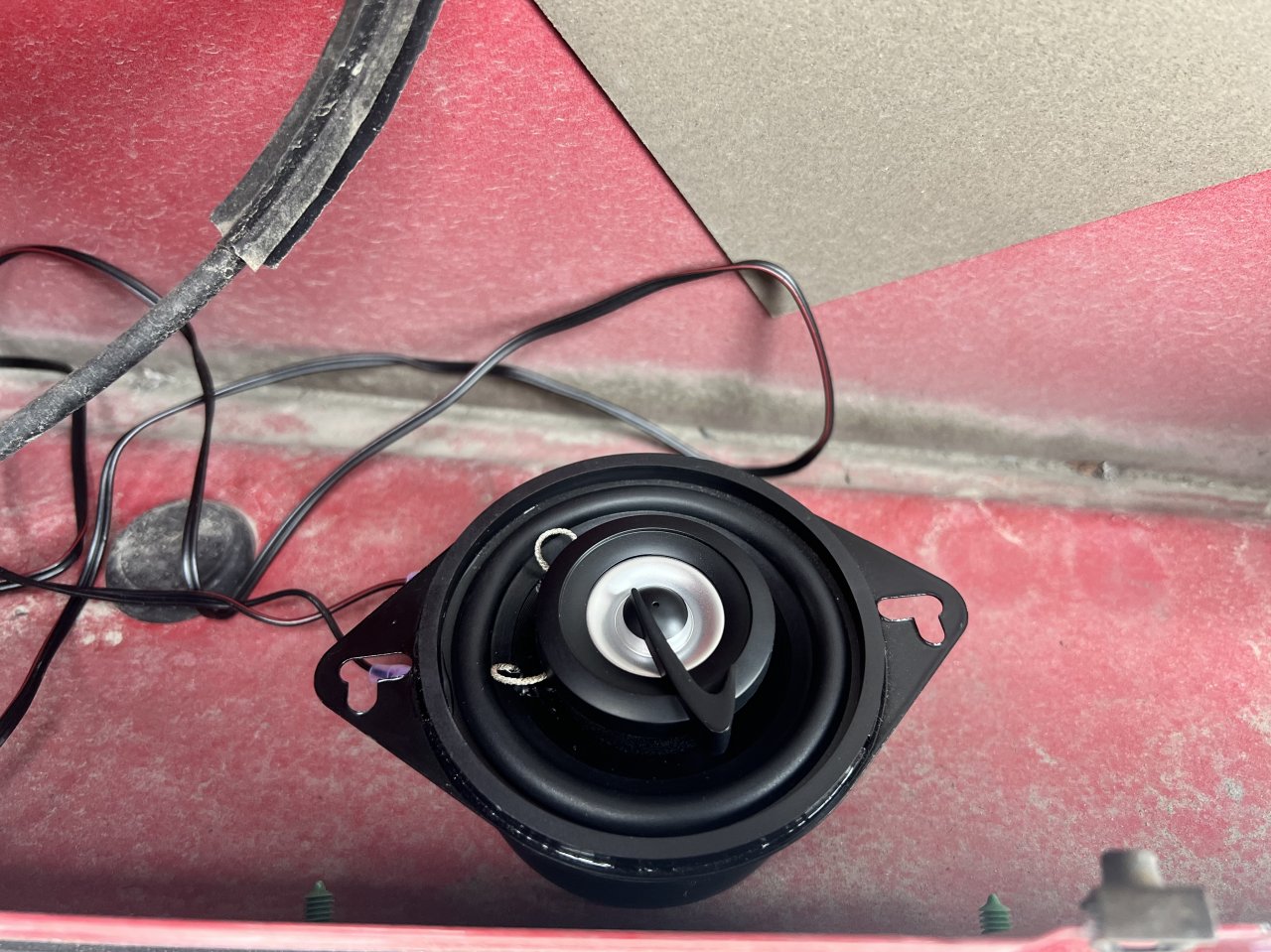

I ended up wiring a small 3.5 inch speaker to the blue harness and my upgraded stereo speaker to the black harness. This eliminated all warnings on the dash. I left the small speakers in the door. Blinkers, warnings and LDW sounds all work but they’re very faint, you can’t really hear them through the road noise.
