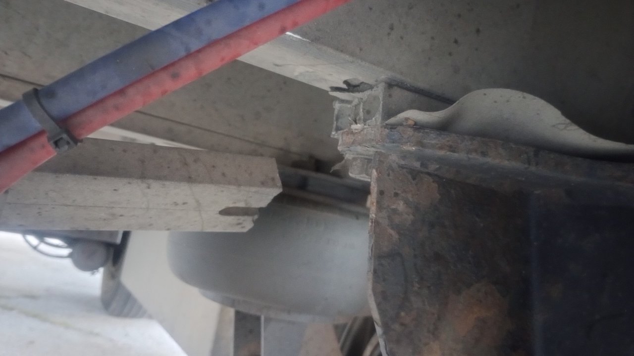

2019 EAST flatbed frame is cracked - is it normal?
Discussion in 'Flatbed Trucking Forum' started by AlexRider3, Aug 17, 2024.

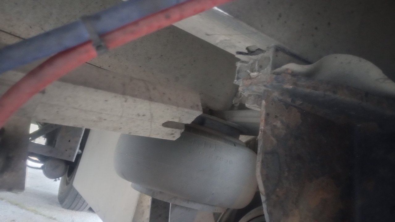

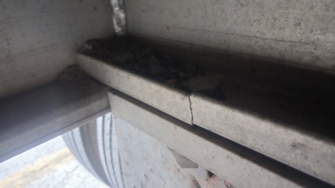

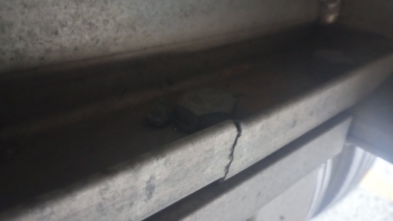

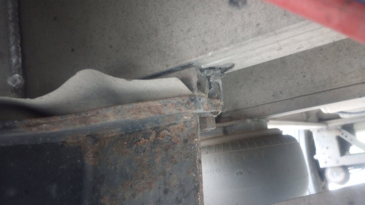

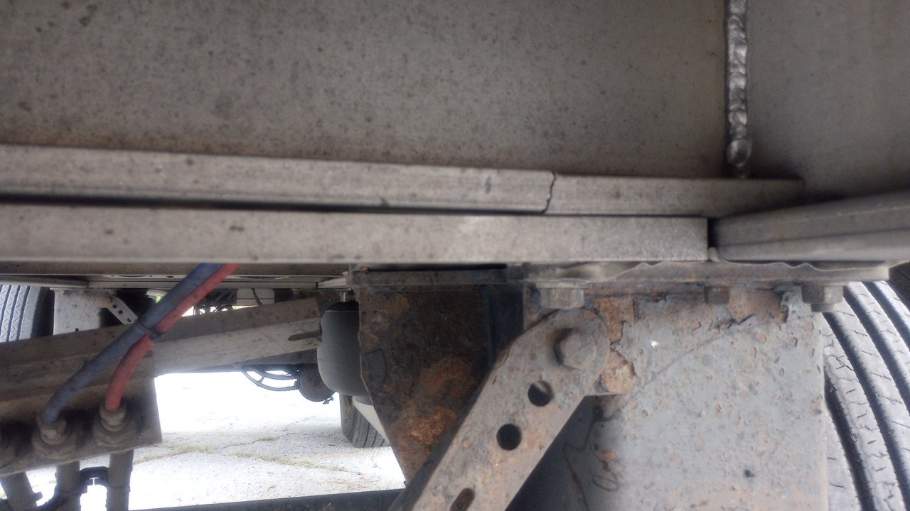

  4. jamespmack
    As stated, hard sharp uturns, sharp backing. Dump valve can aid.
    This is not a break of main web, rails, outter rails. This would not bother me to purchase at a discount price and take home and repair. Unfortunately this is basic maintenance on a aluminum trailer and common. Nothing about it scares me to repair that.
    MACK E-6, AlexRider3, CAXPT and 3 others Thank this.
  5. abyliks
    abyliks Road Train Member
    4,222
    10,046
    May 2, 2010
    ludlow MA
    East trailers suck IMO, but that can be welded, and is common on aluminum trailers
    I looked at a dump with aluminum frame a while back and there was spider cracks all between the tandems and by the king pin
