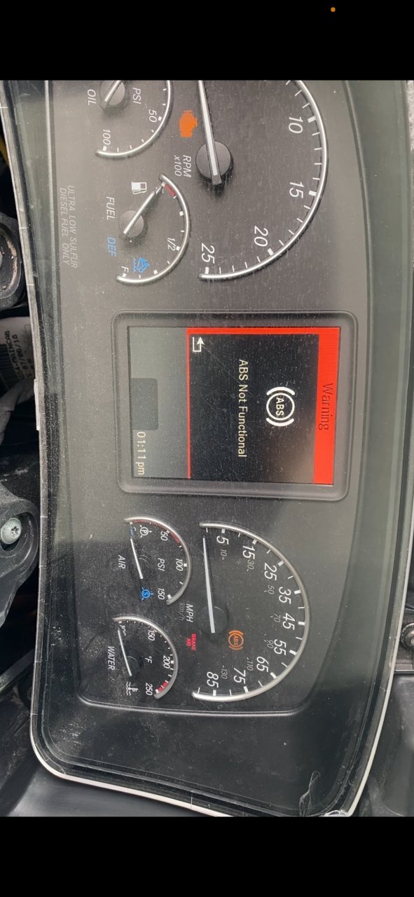

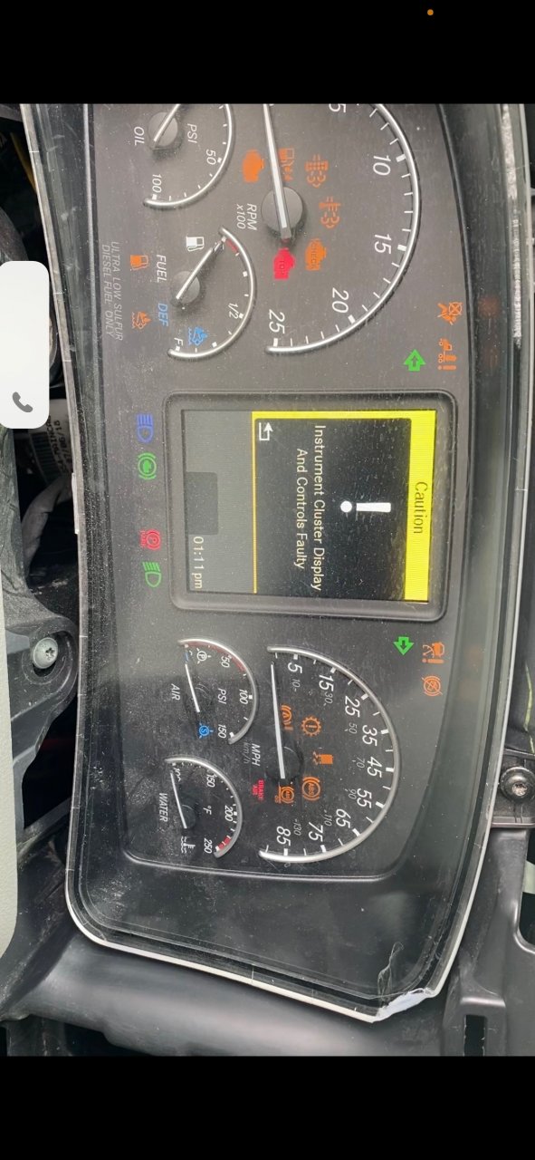

    I have a 2019 freightliner cascadia that I changed the cab and after change it went to turn on the truck it popped up with
    Instrument Cluster Display
    And Controls Faulty
    And all of the gauges are not working
    So I brought a bunch of mechanics and had them take a look at it and all of them said that I need to change the CPC module that the CPC module is not communicating with the other modules so I ordered the CPC module from the dealer and got it programmed at the dealer and then I went to turn it on and same thing no results And also it will not tell me if I’m in neutral or drive or reverse

    Any thoughts of what it can be or any Mechanics on here

    Need to program the cab module, take it to Freightliner.

    Cab module is the original module

    i hate new cascadias ...without DL no way to suggest what to do...
