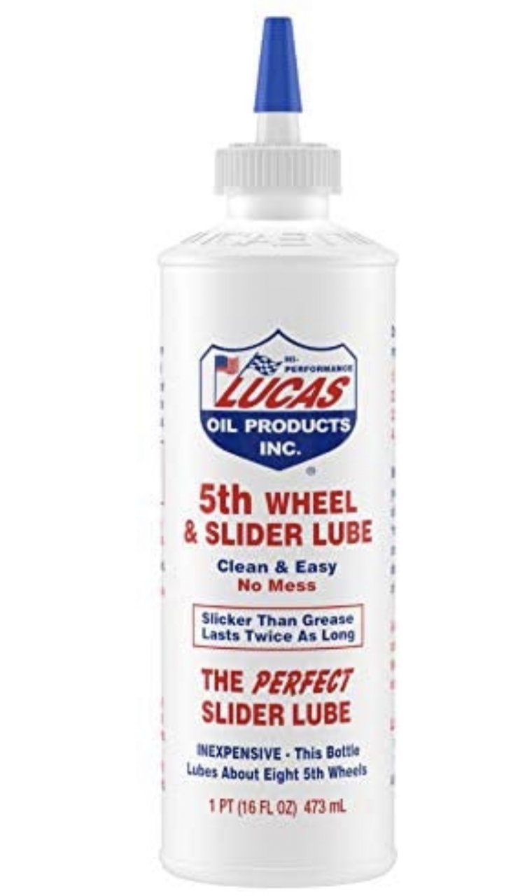

Check the fifth wheel. If it’s dry, it would cause those issues you just described. It’s happened to me. I carry a bottle of Lucas fifth wheel lube. Easy to pour and no mess.
