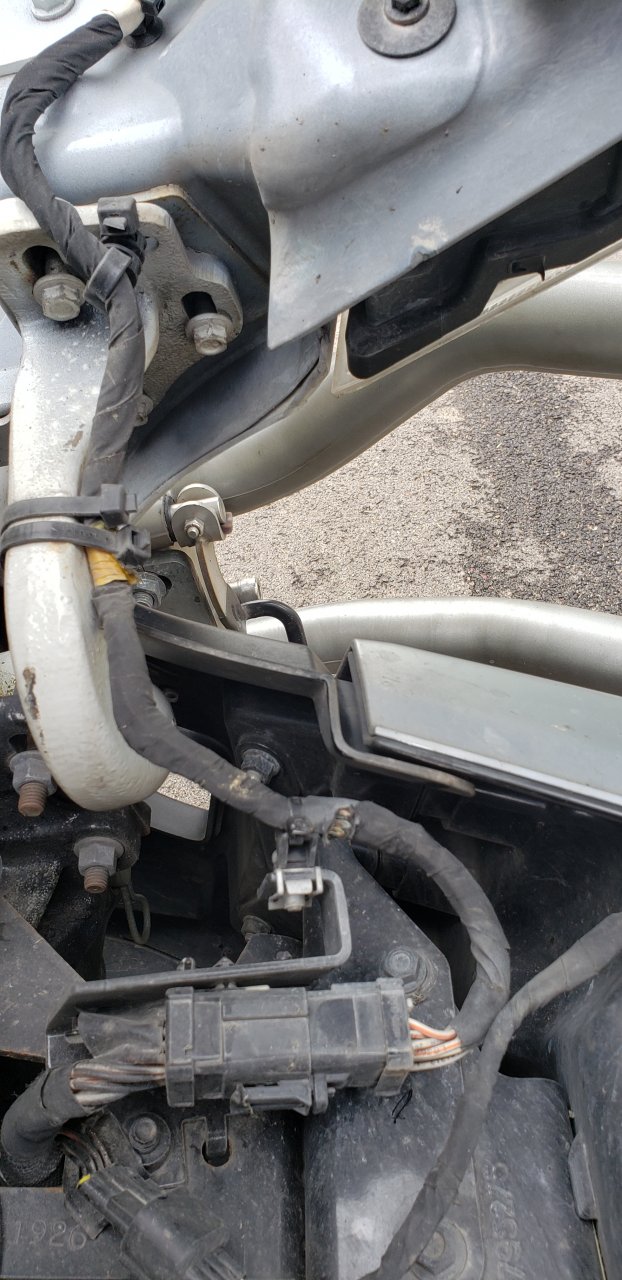

Hey i got 2019 volvo 760 with problem of flickering headlight (low beam, high beam indicator) just one(left side) and right works fine
i tested ground and power it is good up to light itself can someone help please

Are the lights LED? Could be a bad LED module. It's a 2019. The truck should have a 1 year bumper-to-bumper warranty and any dealer should be able to fix it for free.
I pulled all 6 fusses for LIGHT CONTROL MODULES and putted back in and it works fine now thanks for replying
I found on our 2019 the wire harness for the headlights was installed on the bracket upside down. Therefore the hood was rubbing into the harness causing the light to flicker. Check both sides.
Thanks found it both sides same problem
