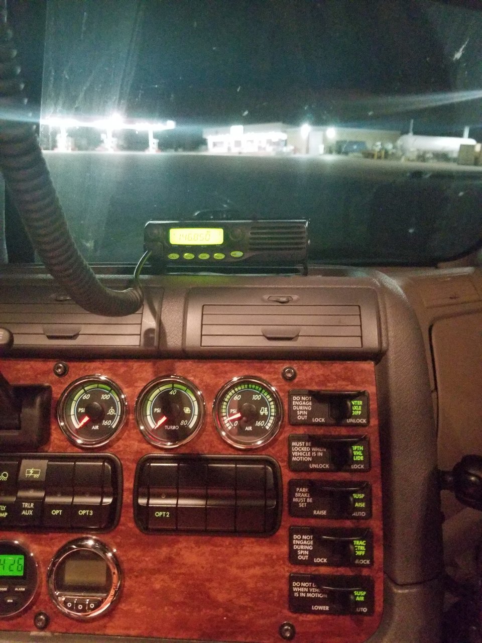

I used heavy duty velcro on top of dash with a Stryker 655. Unit stayed put on all kinds of roads. I mounted the factory Stryker bracket upside down on the radio to give the radio a little upward tilt in the front

This is what I use throughout the truck. The only thing that lives.Timin770 Thanks this. -
