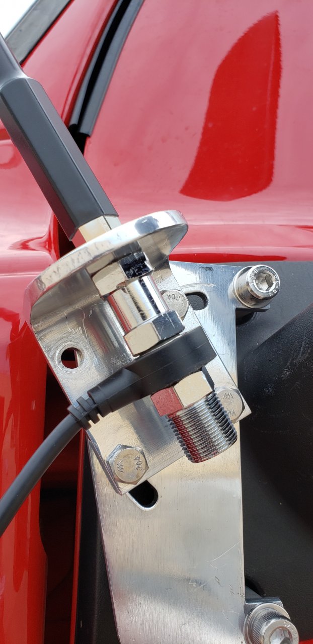

    It’s the same thing that’s on the back of the radio. The so-239 female comes in different styles.
    http://i.ebayimg.com/images/g/fckAAOSw7VBTxAkP/s-l300.jpg
    You just screw the pl 259 on the end of your coax into it.

    The answer is yes. The order of things you have listed is correct. The bottom stud simply screws into the top antenna stud, and that holds everything together.

    After doing some searching, I can’t find a picture of the bottom so239 stud by itself. But you already know what it looks like, because you show it in your first picture. You were using the so239 as a bolt to hold the fire ring coax on, which is wrong. Here’s a real picture of what you already have from Walcott’s.

    Here’s a short video showing how to use install it.

    Ok. I'm not sure where that part ended up since I wasn't using it in my second picture. (In the first picture, I clearly had the connections all wrong.) I'll have to look for it; perhaps it ended up my toolbox. I wonder if the new heavy-duty stud I bought from RCR (delivered yesterday but I'm not home) came with one. Thanks, Night Stalker. I'll follow-up in a few days.

  12. rabbiporkchop
    9,681
    6,549
    Feb 9, 2012
    Wapwallopen, Pa
    It's shorted directly to ground. It won't take long to blow up the radio.
