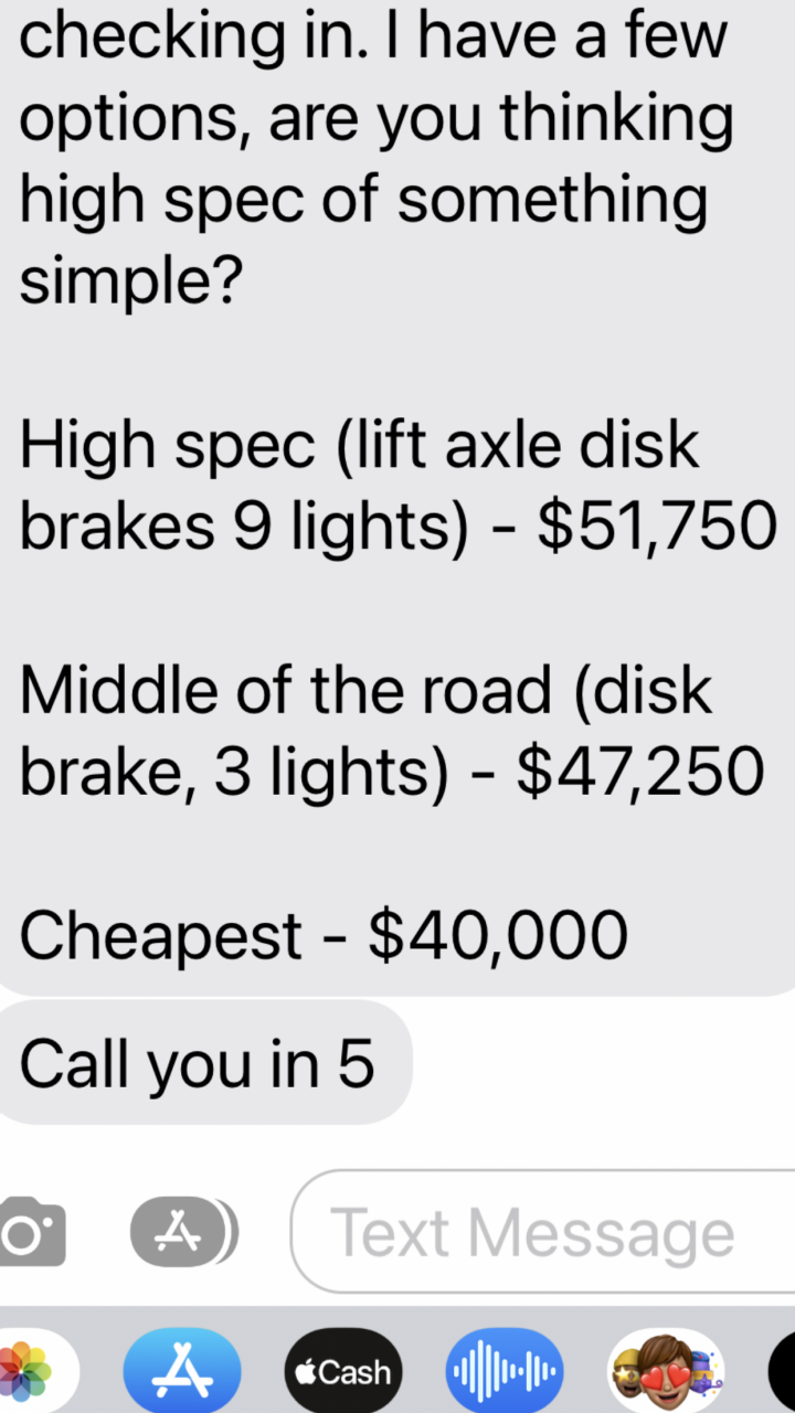

    Called the GD dealership today and got some pricing on new trailers..Think I’m just going to dump a pile of money into mine and get it right.
    Those prices don’t include a scale, skirts or tire racks. Those items and interior lighting would raise my cost another $4k.
    The Hi-Spec is what I have now and was $43,700 complete fresh from the factory. This was at the peak of the pandemic craziness when everyone was fighting over trailers..This dealership didn’t raise my original quote one penny and that’s why I won’t buy from anyone else.
