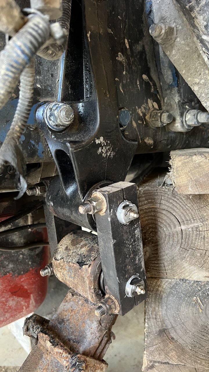

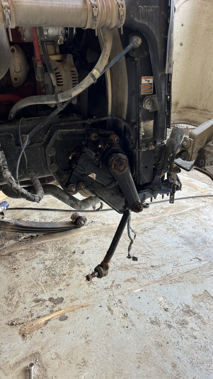

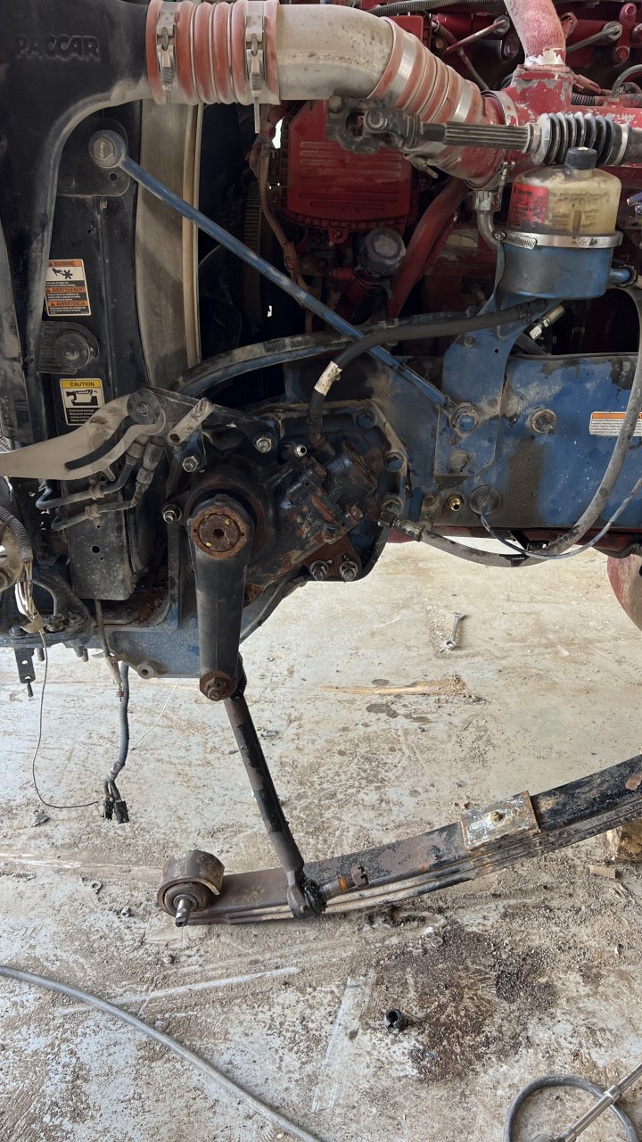

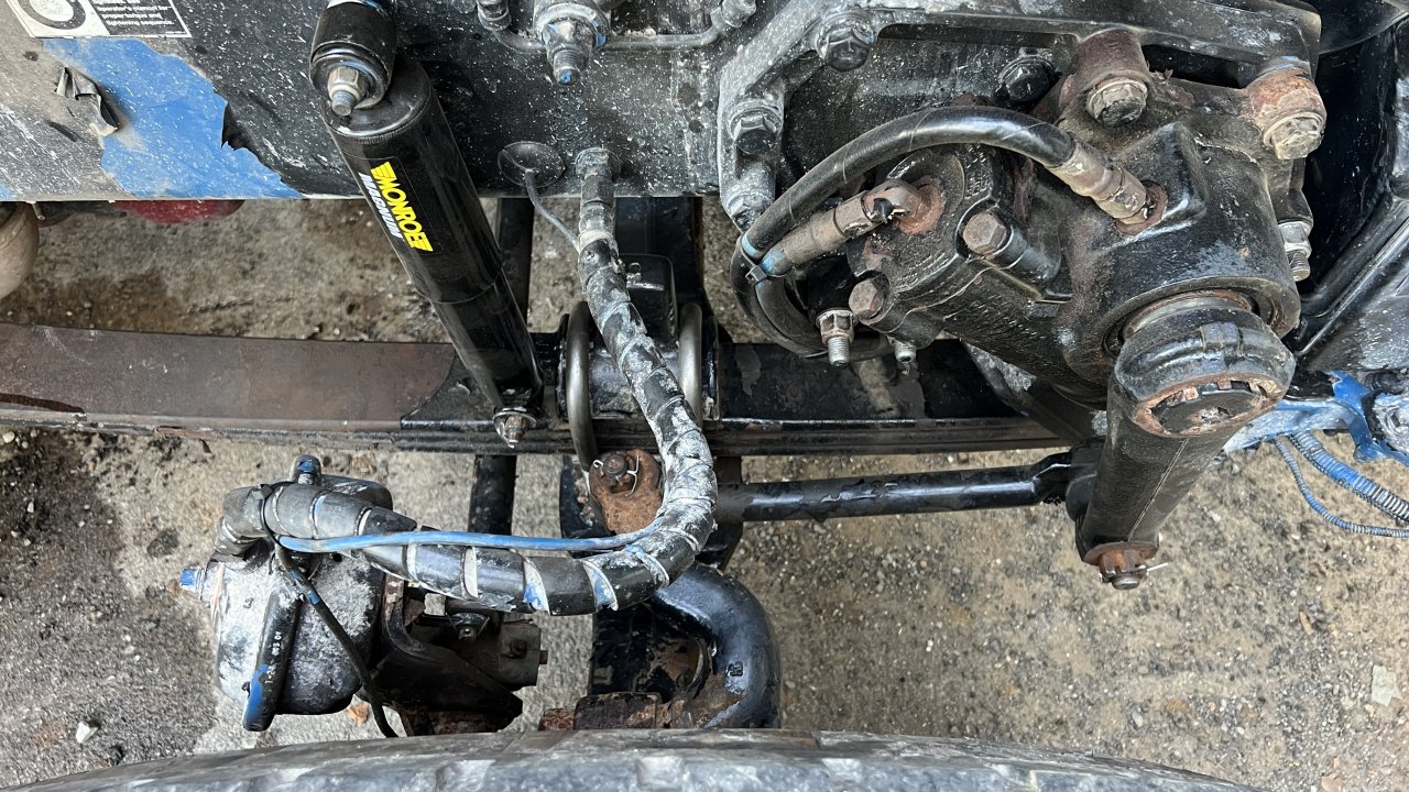

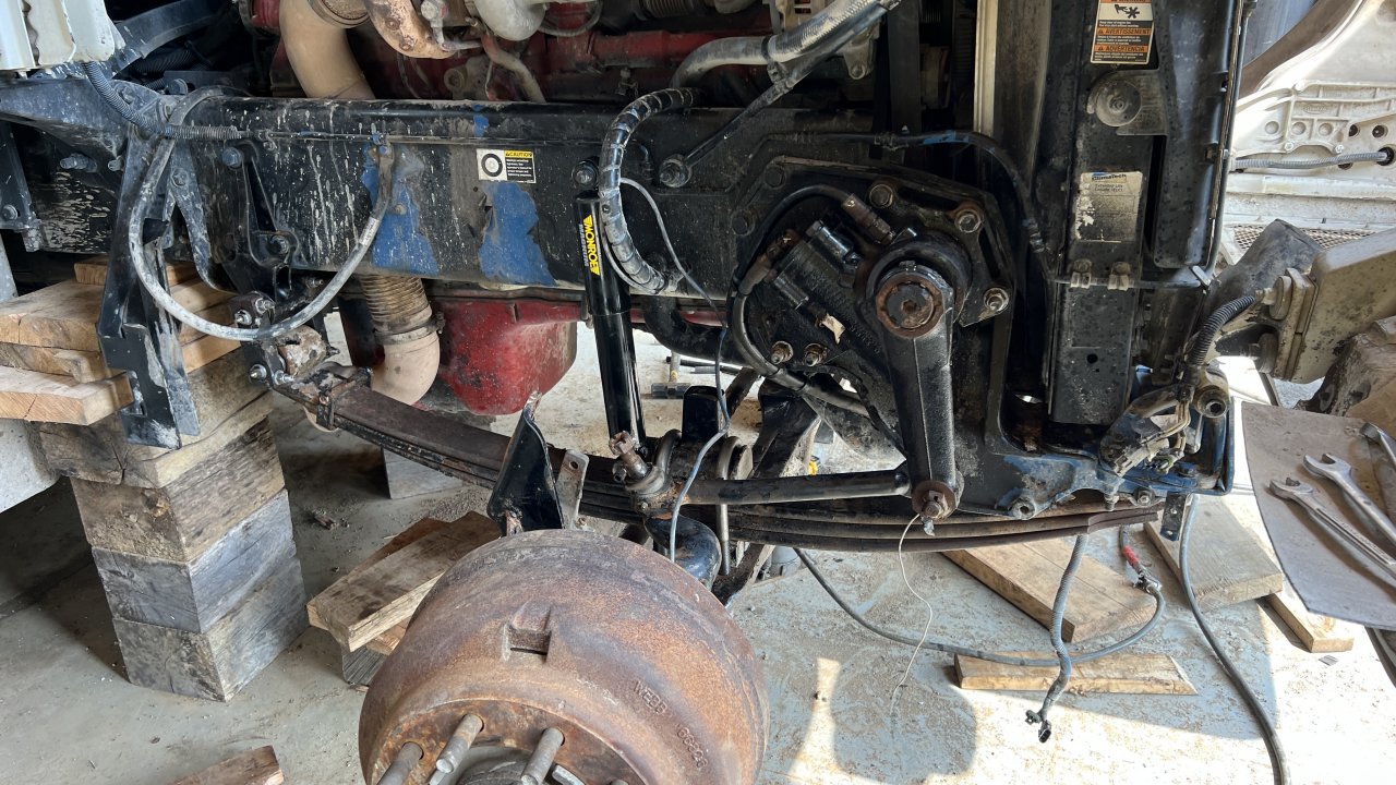

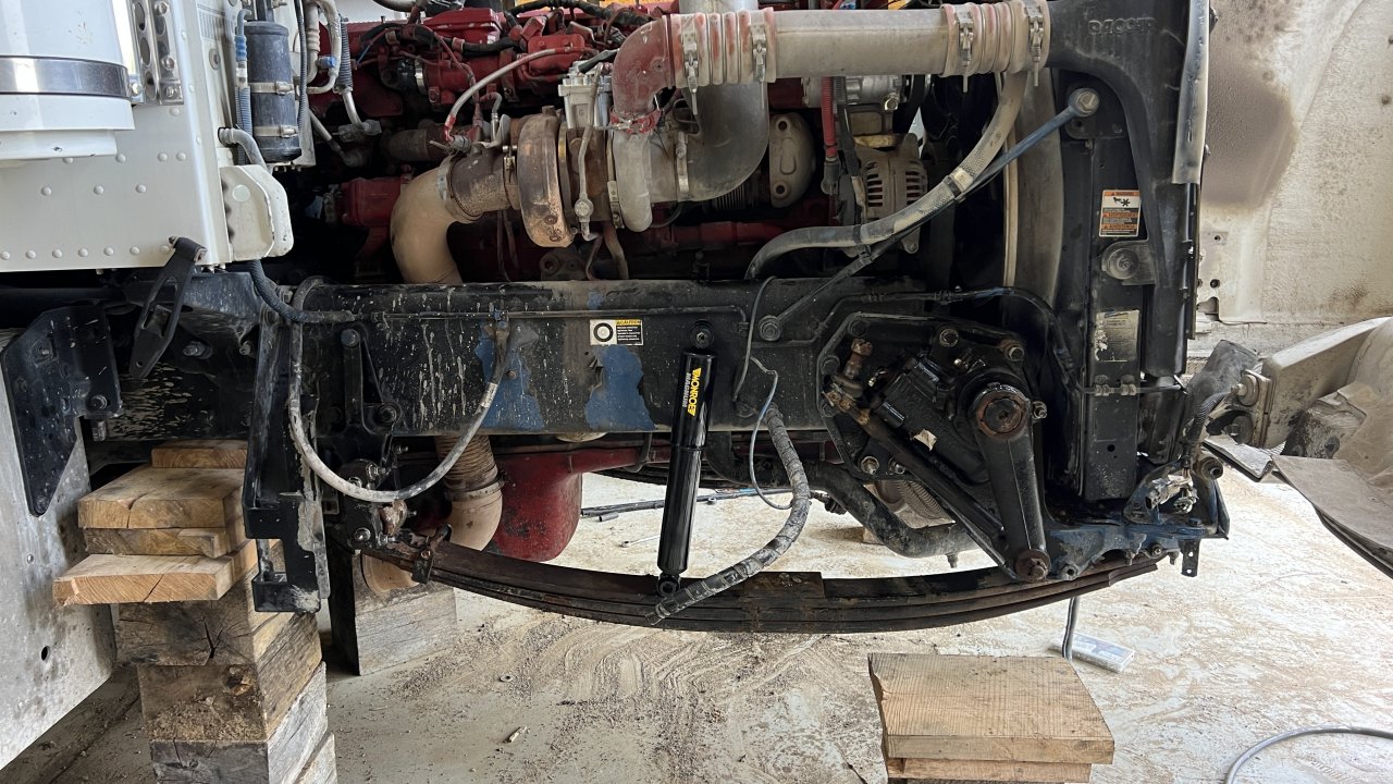

    IMG_3737.jpeg IMG_3736.jpeg IMG_3738.jpeg IMG_3739.jpeg IMG_3740.jpeg IMG_3741.jpeg IMG_3742.jpeg Sup. Just posting some photos of my current project. Converting a 367 triaxle dump from a 12k lb axle to a 20k lb axle.
    Replaced driver side steering box
    Added passenger side steering box
    Replaced spring hangers
    New threaded bushings and pins
    New shocks
    Added 3 leaf springs
    New u bolts
    Pictures are work in progress.
    Should be ready to slide the axle in tomorrow

    In my experience... About the only difference from a standard 12k steer and a 20k steer is the number of leaves in suspension and the tag on the axle. Sometimes the 20k has larger king pins, but not generally.

    It’s a little stiff, but I do have a larger pump ordered. With two gear boxes you need a pump that can handle at least 6 GPM.
    There’s a noticeable difference between the two I have. Larger drums, bigger pins

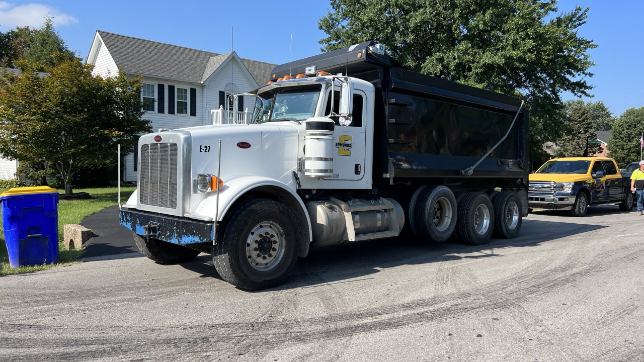

    Here’s the finished project
    KB3MMX and W923 Thank this.
  10. dillydog24
    dillydog24 Light Load Member
    66
    53
    Jun 8, 2020

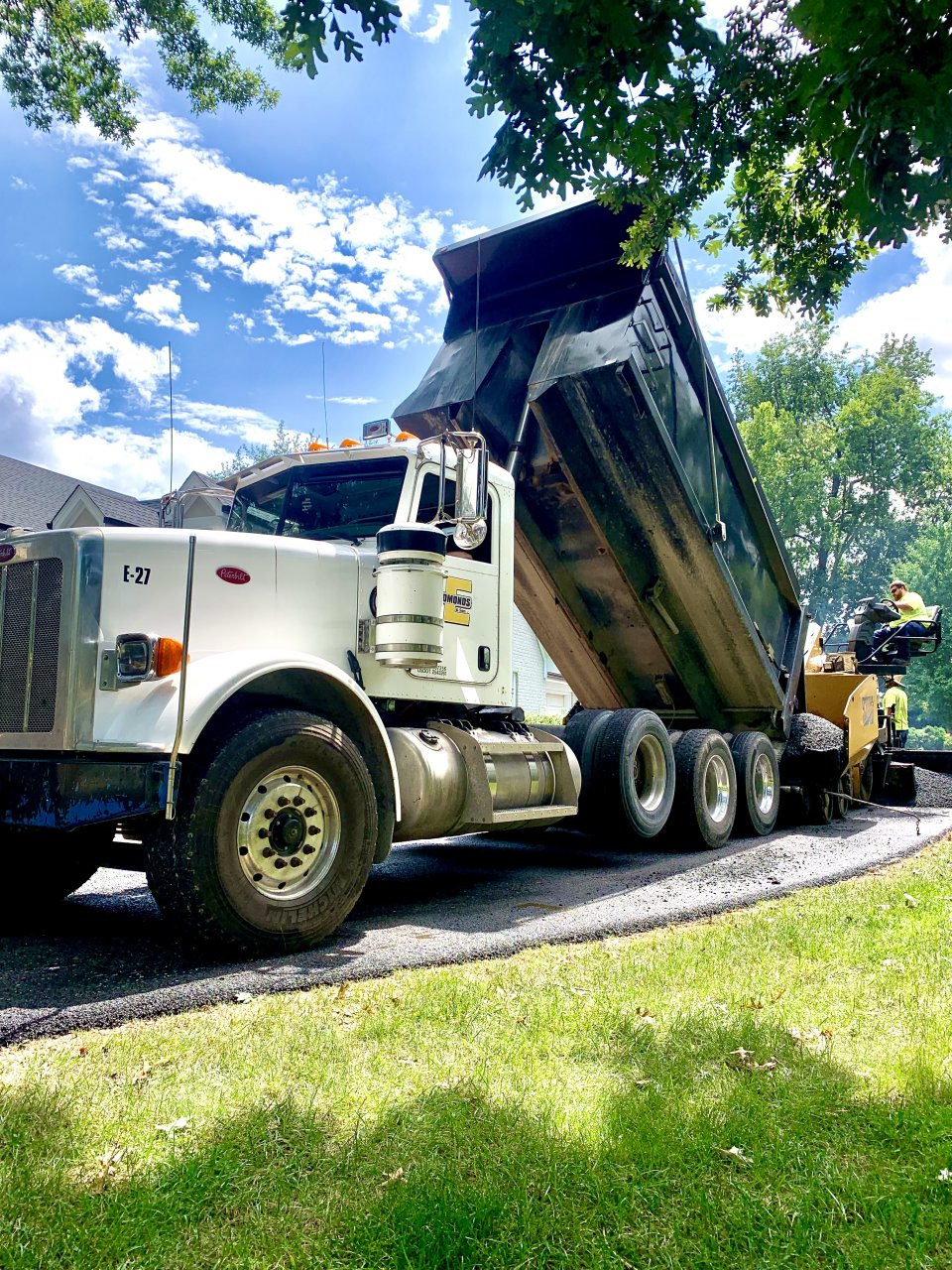

    IMG_2467.jpeg IMG_3760.jpeg Truck sets up better than it use to. Handles like a champ. Feels like I actually have power steering now lol
