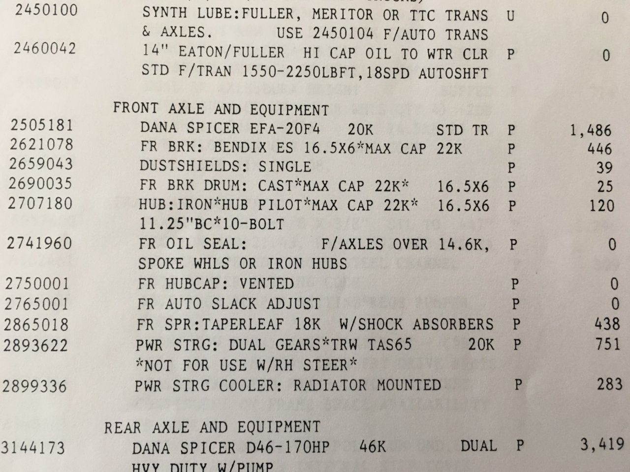

    I’ll look on my line sheet tomorrow and see what it lists for power steering equipment........
    bigbirdmim Thanks this.

  5. Cat sdp
    Cat sdp . .
    21,320
    76,344
    Apr 8, 2012
    Orion's Belt
    My line sheet at the other house.....sorry it’s gonna take me some time to get over there....
    Pm me and I’ll give you my last 6 vin number and you can look it up .....

  8. Cat sdp
    Cat sdp . .
    21,320
    76,344
    Apr 8, 2012
    Orion's Belt
    @bigbirdmim ....
    Found the line sheet, it doesn’t say much
    HP510 and bigbirdmim Thank this.
